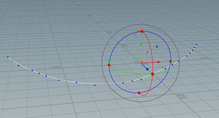

I have a similar issue.
The problem is I want to edit my curve inside the SOP context.
My curve was imported into a SOP from an external source.
I thought I could achieve this using the Edit SOP, but I coundn't.
The Edit SOP shows the bezier curve CVs along the curve, but I neither can select nor transform them.
Curve SOP also doesn't work.
How do I edit a curve inside a SOP if I don't have access to it's creation nodes?

I got the point!
I had to pick point selection/edit from the left menu when using the Edit SOP.
