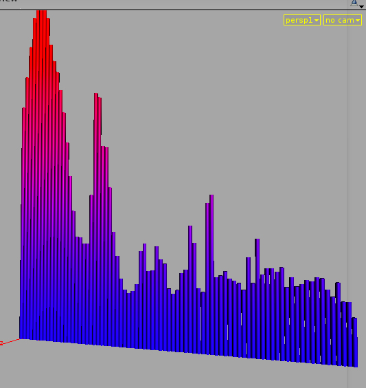

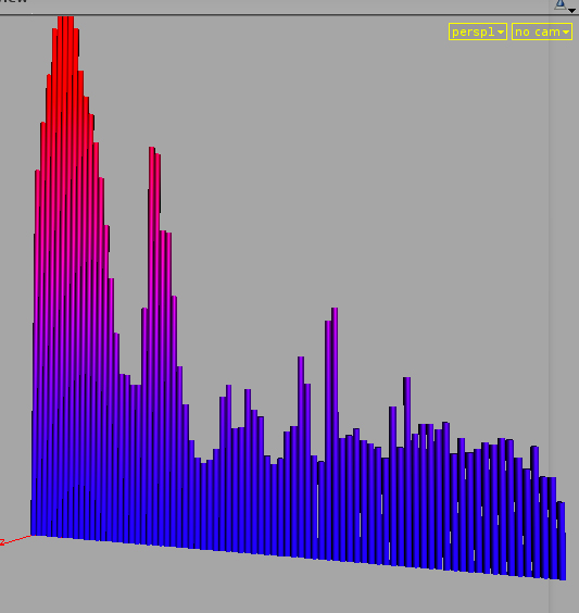

I made a music driven animation. With reference to the past official scene. But I do not know where the problem. In any case can not put under the chopnetwork attribute, delivered to the SOP channal below. Here is the scene file, why is there such a problem.thanks~~
music_2.rar (1.6 MB)
48 posts
Joined: June 2012
good
2012-07-19 下午11.23.06.png (116.2 KB)

Bad.
So pleace help me.
2012-07-19 下午11.23.12.png (56.3 KB)

just because your channels don't match the point number and in channel sop you should use the attribute boxh not boxH. so try to change the Pitch Divisions to 21, and create a new channel sop, I think it will work.
