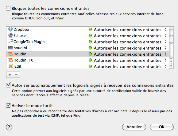

- edward
- 7899 posts
From http://support.apple.com/kb/HT1810 [support.apple.com] it doesn't sound like stealth mode would impact the Houdini licensing. Perhaps you have some other firewall option that was blocking Houdini until you added it to the exceptions list.
