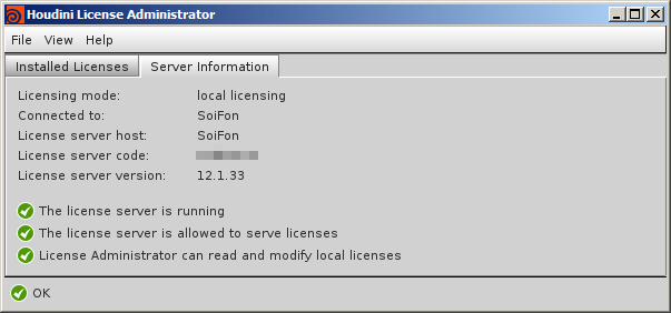

Joined: Aug. 2012
I finally got it to work! I got the correct code and I got three green checks.
I'm just going to hope it won't bug out on me with the licenses again.
Thanks kumara and ragupasta!
-Seven
