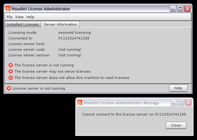

Well, the problem is i'm not using win 7 and win 8 yet, i still use win XP 32 bit. Does Houdini 12.5 Apprentice version can run on win XP or not? i try to install the Houdini 12.5 Apprentice Version for win 7 32 bit on my computer. It ran, but after installation completed and i try to launch Houdini 12.5, window message appears “License Error: Unable to connect to hserver for license acquisition”. Does it mean, it doesn't connect to hserver for license acquisition because i use win XP?

no, it didn't. i've just installed apprentice as usual.. I attached pictures of the window message when i launch Houdini 12.5 and my Houdini license administrator, i hope it can help to know my problem
7902 posts
If you look in your Control Panel > Services, do you see the “Houdini License Server” and “Houdini License Client” services? Are they running? If it is, then also confirm that “hserver.exe” and “sesinetd.exe” are found in the Task Manager.
