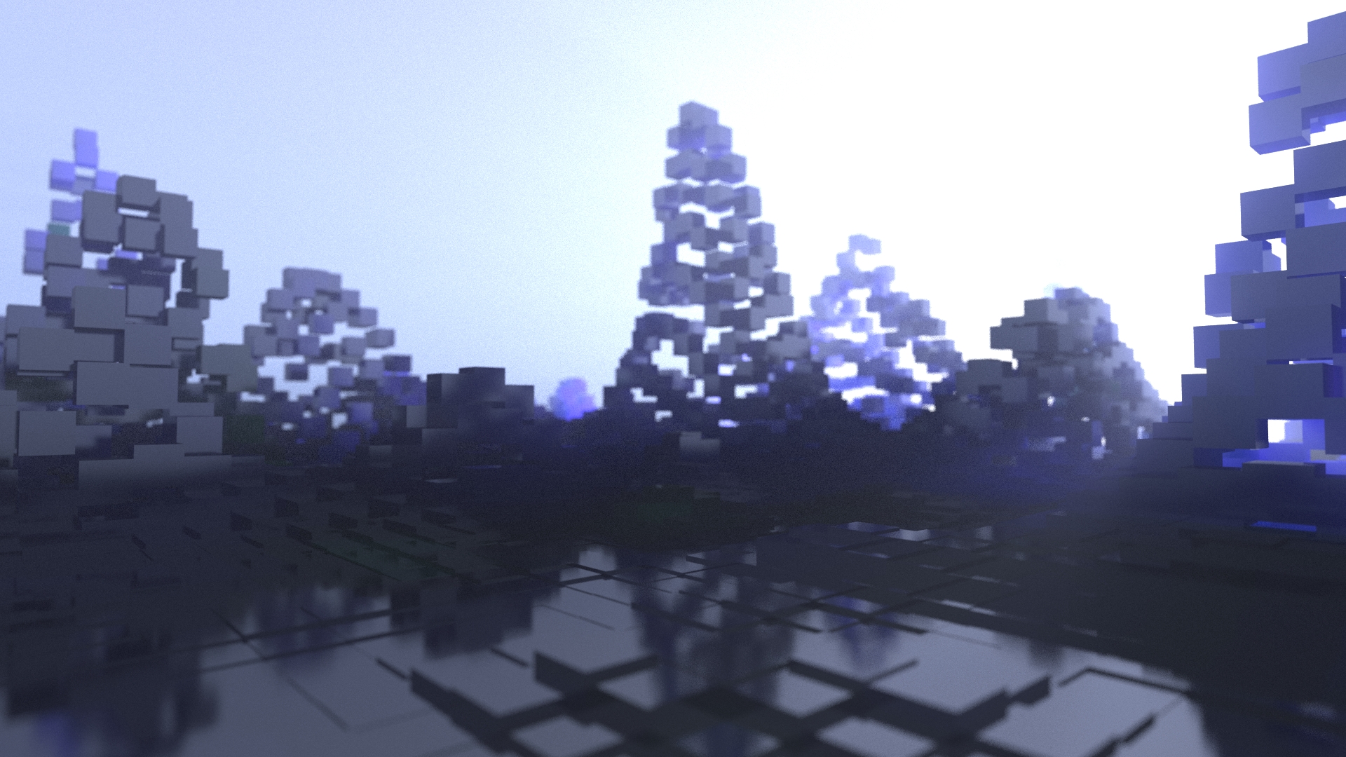

Setup in houdini, nothing I couldn't have done in SI
, exported as alembic to SI and rendered with redshift. It has brute force GI 3 bounces 256 samples, SSS, bokeh, motionblur and environmentscattering (fog). Rendertime 4.12 min in full HD. With the same featureset mantra didn't even start to render in this time.

here is the scene without the geo. You see the mantra settings though. I tuned the sampling until the GI was noisefree and turned the fog on. It is the sample fog object that comes with the scene from the houdini help. Without the fog my scene renders with a “normal” softwarerenderer speed which still is of course much slower than redshift. You can't beat redshift. It is the only renderer that renders Environment fog/scattering in a reasonable time. So I render where it is supported.

It'll be best if you could share a file complete - loading Indie files into an Fx license reverts to limited resolution non-commercial upon saving and opening. Makes it very hard to test! Just .zip it before uploading if the size is big for the forum.
Using placeholder geo, and substitute colour maps, you can see when you turn on Verbose Level = 4 in Mantra/Properties/Statistics and check ‘Alfred Style Progress’ that the main holdup is using a ‘fog’. Try using a volume node instead and apply a constant smoke shader.
The environment light simply Quality set to 4 is quite high as it's a multiplier on the Mantra settings.
The file size is mainly due to the mantra and clay shaders. Try deleting them and saving the file to see how much space they take.
