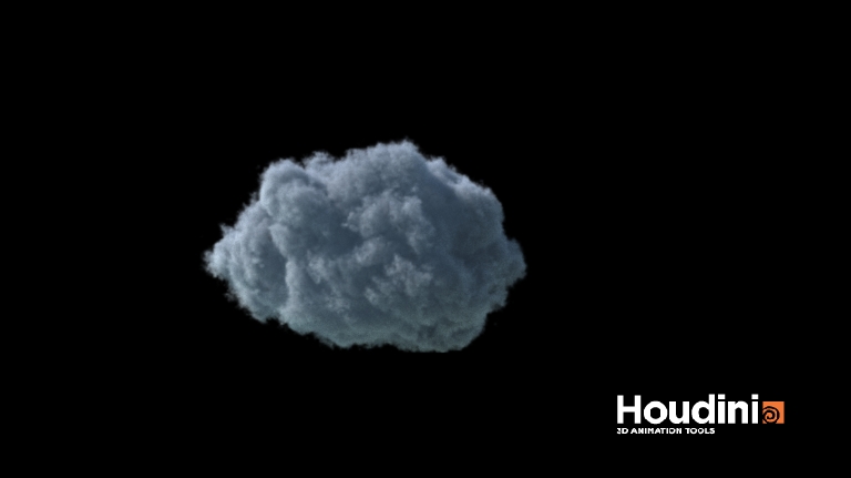

Hey sjowol,
Would be nice if you can post your file so I can see what's wrong.
For now, here is a file with a basic Cloud Rig and I've setup Mantra node with it.
I rendered with PBR. I haven't set the values to the maximum and it's already giving me a decent result and with no grain.
You can lower the Noise Level and have more pixel samples but not sure about your scene setup.

looks awesome!
unfortunately not too much time to clean this up and post something but instead of just the one cloud i have about 1000 point scattered, copystamp spheres on top of that and then fill those with clouds… just quickly did that with (approx) your settings and get it super grainy. your max axis res of 100 is pretty high, for my scene that is simply not a feasible number, i am using div size of 0.04 any lower then that I crash (win7, 8core i7 3.33Ghz with 24 gig ram)

So basically you can't have one scattering of clouds and expect to have the same quality for the ones close to the camera. Split them in maybe 3 different setups.
> a couple of High resolution clouds in front to the camera
> Mid resolution clouds further away like the file I sent you now
> Low resolution for the ones in the back.
This way you can optimize your scene and the ones in the far end won't have the same resolution as the ones up-close.
Check this file that I attached… this is one good way to scatter clouds without using a copy sop.
As for the movement of the clouds, you can get great results by animating slow change in the Noise offsets and the advection time variable. As for the per cloud speed control, I will have to take some time to see what could be done and i'll get back at you as soon as possible.

Yes, that's because you can play with a couple of variables to achieve that.
First one thing I notice is that you are working in non-Linear color space. This mean that your image will come darker than mine. It is always recommended (it's a good practice especially if your working in a production) that you work in Linear color space. There are tones of information on the web about the technical part of it which I'll spare you for now.
To switch to linear in Houdini, go edit > color setting > color correction, set your value to 2.2 and check all the other options that you want to affect (ideally all of them).
Now that said, you can play with your density and the ramp of the cloud. It will help the translucency effect.
Also if you check your cloudlight node in the cloud rig, in the light tab. You can put a brighter color to the light, for example a light grey. (which I think in your example I did a darker blueish). You can play around with the propagation tab but in my case I left it to default.
Last thing you may want to check is your shader. You have the Single Scattering Phase variable. This tells mantra how light bounces inside your cloud, which helps you get this translucency. By default, its at 0.2. Try a value of 0.5 or 0.6. That should give you a close enough results.
There is no specific recipe for clouds, it will depend on what type of cloud you want to achieve.
hope it helps
