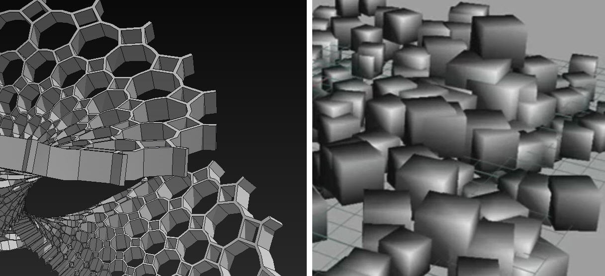

Switch to Flat Wire Shaded and set the viewport background to Dark in the Display Settings. I think that's the closest you can get.

If you are talking about the hard edge look…append a vertex Sop and under Normals select Cusp and keep the default 20.
I will be more specific. I really don't care about the background color, I know I can change that. I'm talking about the curious issue where the illumination of each object with its over overexposed lighting look, is predominant over a global scene illumination strategy, regardless of how many objects are in the scene.

That look is because the shading on each face is blending to the next face. The shading is bleeding from one face to the other because the edges are not cusped. The Vertex suggestion is the best to get square shapes to shade properly without changing the point count on the object.
Sidefx could create square shapes with vertex attributes set this way but in Houdini these steps are generally left in the artists' control.

This is a quick setup with a bunch of boxes cusped to look like boxes. One point light with Physically correct falloff, one ambient light. Viewport settings:
- Shading mode to Smooth Shaded ('box' icon on the top toolbar, to the right of the path gadget)
- High Quality Lighting with Shadows (right toolbar, icon just above the sunglasses icon)
- Specular highlights off (RMB on HQ Lighting icon, toggle Specular off).
- Shadow Quality = Antialiased Point Shadows (RMB on HQ Lighting icon)
- 8x AA (display options, hotkey ‘d’, effects tab)
- Ambient Occlusion @4 (display options ‘d’, effects tab)
- Gamma @ 2.2 (display options, viewport tab, color correction group)
After that, it's just a matter of adjusting your ambient light and point light to give you the exposure you want.

I'm familiar with the cube icon: and its settings. Its sad that there is nothing more sophisticated offered in that dropdown list at this time.
On my wishlist I would expect a basic parallel ray, light source like the sun, whose shadows I can be adjusted easily given time of day, and city location.
I don't think too many new users are willing to remember a 6 step procedure to get basic lighting information into a scene, nevertheless I appreciate your How to light a scene contribution

All the display options settings can be made permanent by clicking the “Save as Default” button in the Display Options dialog.
There is also the SkyLight tool in the Light & Cameras shelf, which is pretty much your “one button press” solution for creating a distant light and an environment light with the appropriate lat/long/time-of-day controls (near the bottom of the skylight parameter dialog).
After that, it's up to your artist to light the scene properly, which I don't think is too much to ask of a lighter.
