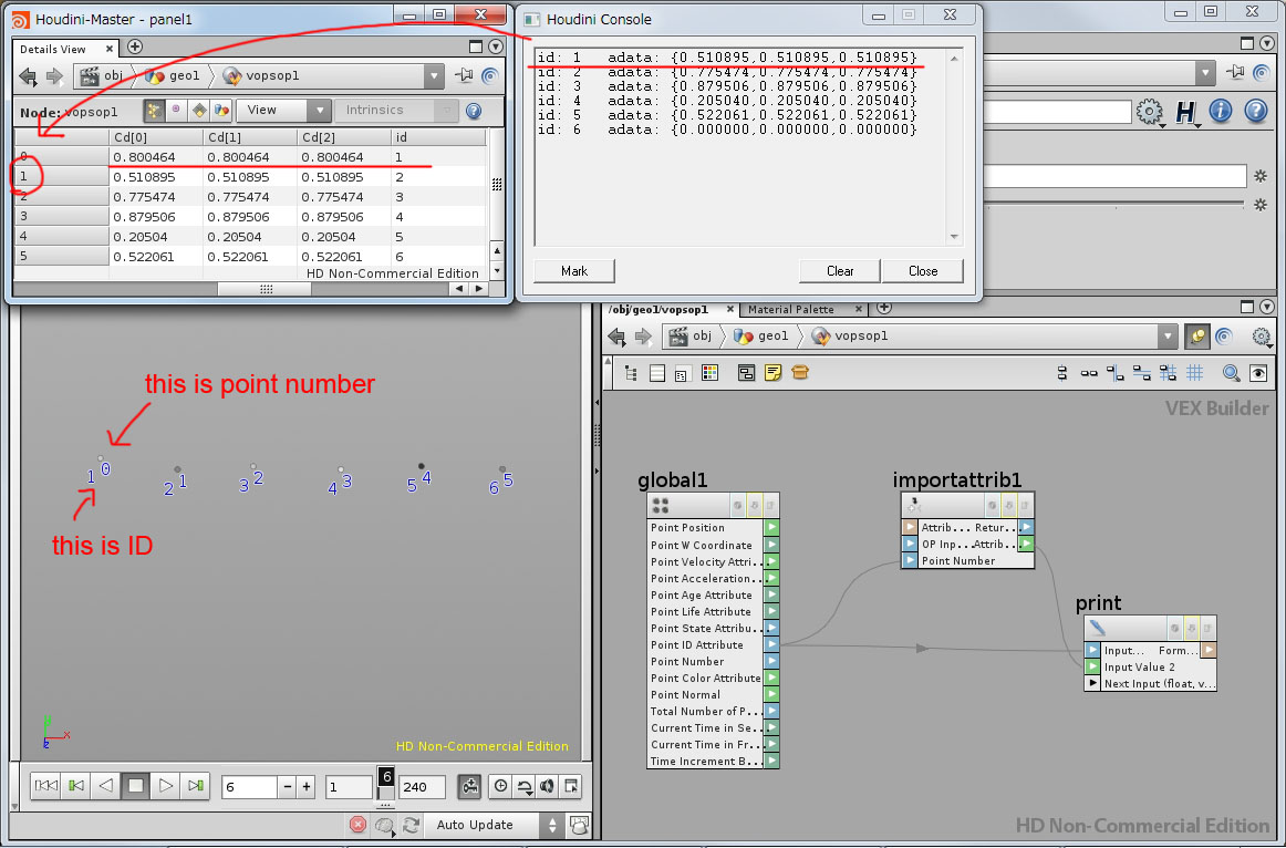

Hi Laiwayne, I checked your file. but it seen still to find point number not to find ID
I changed your setting LIFE to Cd, so can clearly to see the result.
as you can see in Console, the id:1 has a Cd {0.510}, but {0.510} is not id1's color, it's id'2's color,
because even I give a id value “1” Houdini will go to find which PT value is “1”…Orz

it doesn't work with POPs for the same reason as pointcloud lookups or other VEX functions that need to sample geometry from outside using op: syntax
there are ways to do that by using POPs in DOP context and therefore having access to geometry from previous frame you can sample with op: context either in pops directly from outside or in SOP solver which operates on the same geometry as POP solver
