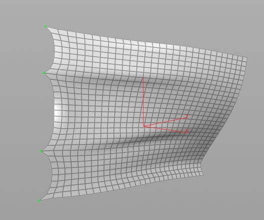

After watching the old masterclasses was able to do just such a flag.
He does not behave properly, but I can not figure out what was wrong.
It freezes and does not develop. very strange cloth.
I tried all the options, but nothing comes out
and I have not found any information about H and cloth in the network
documentation for information counter is very small, and the lesson “How to make a waving flag” is not working

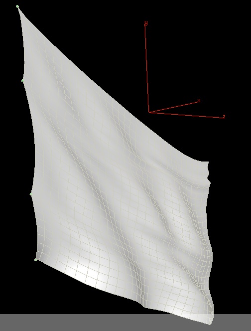

A few things.
Noise on wind. You set Roughness to 1 (default) but you set Turbulence to 0. This means no additional octaves of noise to give you nice turbulent effect. Set to 4 for the given resolution of the mesh and see if that helps.
Try anisotropic noise on the wind. Set Amplitude for X and Z say to 5 or 6 and leave Y on 3. Assumption is that the noise moving fast past the flag will have more strength in the XZ plane and less in the Y.
Go much higher with the Normal Drag on the Cloth Object DOP. Go even lower on the tangent drag.
These two parameters are what most likely will affect the flag behaviour the most. The tangent drag is the part of the cloth surface that is in alignment with the forces (wind) and in this case little drag will be applied.
The Normal Drag is the part of the cloth that is being hit by the wind. With a larger value, the drag will be higher and will cause that part of the cloth to have more damping.
Manipulate both. Generally Normal drag is much higher than Tangent Drag.
Try Normal Drag at 20 and Tangent Drag at 0.01.
Leave the shear at default 200 and then reduce the Weak Bend Stiffness to a much lower number, try even 0.05.
You could even further tweak the wind amplitude in CHOPs to get more wind bursts with lulls.

I removed all tweaks and settings and set parms to default.
It is better to use the vel direction right in the Cloth Object DOP. Wind DOP just doesn't work nearly as nicely as the vel direction on the Cloth Object.
Mass of Cloth has an effect so try making heavier or lighter to suit but I worked at it's default. This is a large flag at 1.5 meters in length. The only thing I changed was the thickness of the cloth to help with the penetration. Note that this will increase the mass as the volume (thickness) of the cloth is multiplied by the density.
Note that you can go to the Cloth Solver and change the Spatial Scale to make a larger or smaller scale. This scales all the internal properties of the cloth. It works pretty well. Allows you to change scale without changing anything else.
I set both stiffnesses to negligible values or 0. I set the shear down as well.
I set the Normal and Tangent Drag way to high in that previous file. Too much drag will make it seem stiffer as you noticed.
See the attached example file. Looks more organic now.

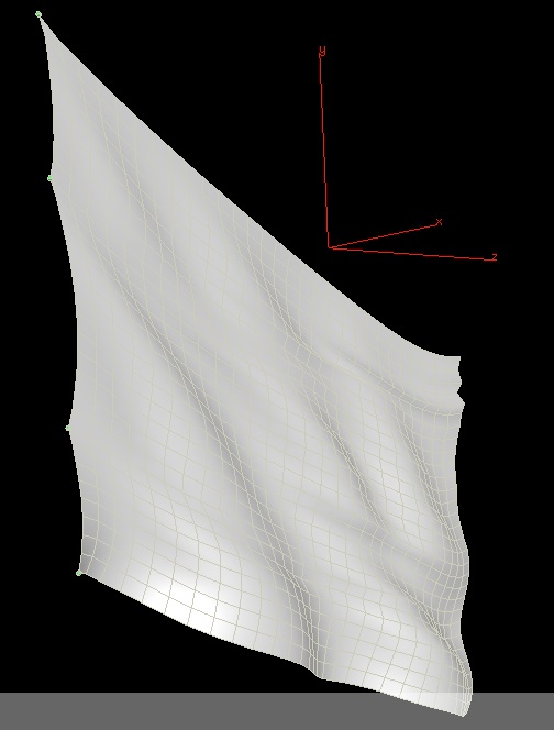

Looking at some real reference footage:
http://www.youtube.com/watch?v=KTfT2AFWJQQ [youtube.com]
and
http://www.youtube.com/watch?v=Lm_imE1a37Q [youtube.com]
That first sim, the flag does look stiff.
The second reference shows nice rippling from the top attachment point and again the flag looks a bit stiff in the wind.
After running the sim a few times, I can see that the leading edge of the cloth can change the sim as it flaps back and forth.
The ncloth sim doesn't get the nice waves draping from the top attachment point and rippling through, probably due to the two attachment points and the front leading edge gets caught up and doesn't flap back and forth to induce the ripples propagating down the flag.
I attached another Houdini scene that hopefully gets a better result. Byy adjusting the vel direction you get rippling and draping somewhat similar to the real flag reference. I put a noise() expression in there to vary the velocity force a wee bit.

Use Cloth Solver for Cloth imho in H14.
If you wanted to try an alternate solver, it would be the wire solver which is a point-edge solver similar to nCloth. The wire solver can solve against poly surfaces as easily as it does for wires.
Using Grains for cloth is fine but I'd resort to that if I was combining this with other grain objects. For example using cloth like attributes for a top layer of Sod with a second layer about 0.2 units thick for roots then under that 1 to 2 metres of clay mud like stuff for flying crap in to ground.
Sticking to the Cloth FEM Solver, just get your flag to drop nicely first. Bypass the Wind Force.
See the example file I worked up on top of yours. I backed off a whole bunch of stuff then worked it up bit by bit. I put the notes in the file. It's getting better but I still would like to add much more “character” movement to the flag.
