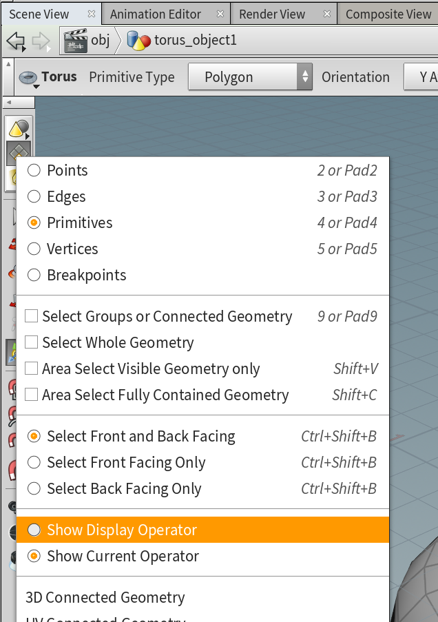

If you RMB click on the Select Geometry tool (2nd icon down on the left toolbar), you'll get a menu with a radio list at the bottom - “Show Display Operator” and “Show Current Operator”. Change this to show the display operator, and it won't display the current geometry in the viewport when you select a SOP.
How do I do this in Houdini 16.5?
5212 posts
It hasn't changed in 16.5:

If you RMB click on the Select Geometry tool (2nd icon down on the left toolbar), you'll get a menu with a radio list at the bottom - "Show Display Operator" and "Show Current Operator". Change this to show the display operator, and it won't display the current geometry in the viewport when you select a SOP.
my goodness, thank you!!! This was driving me insane!
