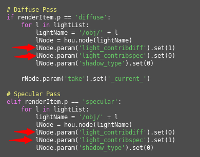

I had a question of python code of light node. How can I load the parameter of contribname in light node? Please saw files in the attachment.
I use Houdini 13.0.314.

I don't know this for a fact, but I suspect you might need:
lNode.parm()
instead of: lNode.param()
lNode.parm('light_contribname1').set('diffuse')
lNode.parm('light_contribname2').set('specular')
Multi-params are accessed by replacing the hash sign in their parm template name ('#') with their index digit.
