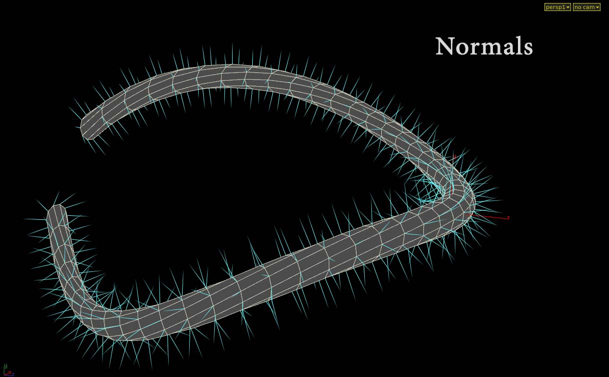

But when you use Copy SOP , It can copy objects along Normals by default !
Check attached images.
About using VOP method , I said before you can import Up and N vector in the VOP SOP , then using Look At node for rotating each copied object along N vector.
