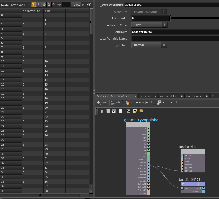

Add Attribute VOP and addXXXattribute() VEX functions just create new attribute on the geometry, and the value you are plugging in is the default value of that attribute so it's the same for all
to populate the attribute use Set Attribute VOP
it is useful if you are planning to create and set attribute values for other than current point(, prim, …)
if you however want to always write to current point(, prim, …) use Bind VOP instead
