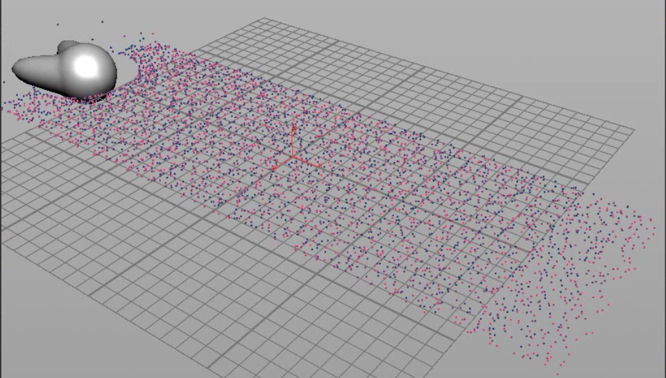

I will try to explain on the pictures… Pictures 1 and 2 show the movement of the lesson. Metaball when driving, leaves a trace, like a ship on the water. When I run the same lesson, all the points are returned to their original places. (pic 3 and 4)
What could be the reason?

As the other post indicated you are following a tutorial that uses the old deprecated particle system. I uploaded a video for you to show you how to do them in the new H13/H14 particle system.
The link is:
https://sidefx.box.com/s/j3hkr0knw5oitb828inagq3u6vhtmoon [sidefx.box.com]
You should also try the following tutorials to get up to speed on the new particle system:
https://www.sidefx.com/index.php?option=com_content&task=view&id=2574&Itemid=389 [sidefx.com]
https://www.sidefx.com/index.php?option=com_content&task=view&id=2635&Itemid=389 [sidefx.com]
I hope the video and the tutorials help.
