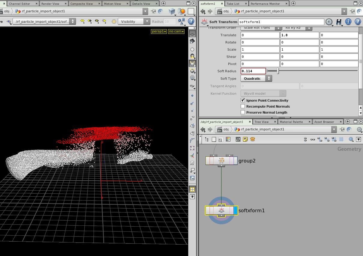

I am loading a Real Flow particle sequence and I want to perform some twists and bends, but i want to be able to use, say a box, to define a region to apply this manipulations.
I know of soft transform…but that doesn't pass (or i dont know how to) the soft selection..any Ideas?

i do…i drop a group sop, tick Enable Bounding Box..i move the bounding box,,,but is not selecting the particles as they travel trough it.
the bounding box would be picking and unpicking particles as they pass tough..so dont know i that is the problem..but i can see any section or elements in the group..

yes that is correct…so it is selecting fine ..but now the soft transform makes something odd to the selection boundary..
instead of feathering the rectangle evenly, it does some weird extensions to it.
my next question to how to fix this is, if the selection group passed to say a twist, can have weighted particles?
