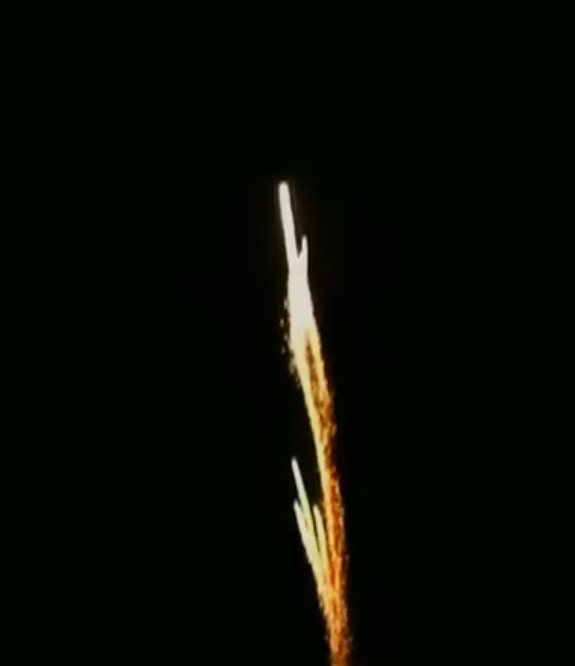

So I tried using stacked POPs and it really worked out great for this setup…
http://vimeo.com/123357428 [vimeo.com]
…but I've gotten a scene file with a working setup using the groups for doing this and I will dig deeper into it and make sure I really get how they work. I just love TP and how you work in groups and if you can use the streams like that, shuffling particles in and out of streams, it's just something I need to know inside- out.
