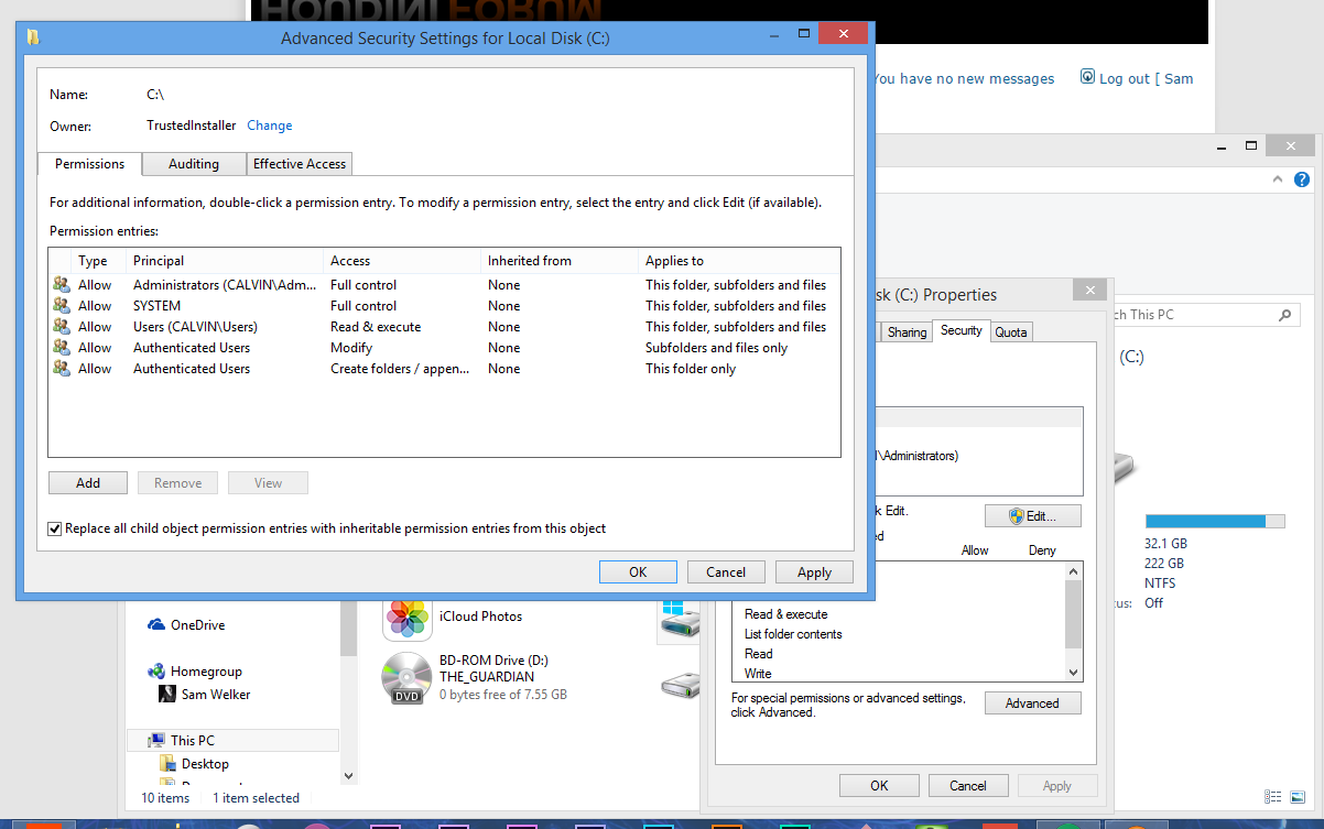

Joined: Aug. 2013
Fixed it. I reinstalled H14 earlier, no luck. Tried using Tune Up utilities to clean up my SSD and Registries. That might have helped.
I think what fixed it was this: http://www.kossboss.com/windows-8—permission-issue-fix [kossboss.com]
I followed the first GUI instructions he gave more or less.
Here's a screenshot of the area that fixed it. I had to use the admin account (my account) to change permissions (by clicking change permissions) then got to this part. I check the box and hit apply and it worked.
