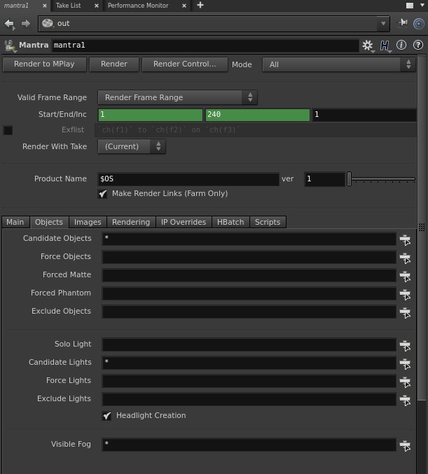

Assuming in my scene there are no lights, no hdri maps, just a simple plane and a sphere, I'm expecting to hit render and see nothing, just a black image.
Turns out I can see the objects with a basic minimal lighting.
The only case similar to this one that I'm aware of, is in C4D which comes with a default light when no lights are in the scene.
Unless Houdini share the same default setting, I don't understand where the light comes from. Is that normal?
My set up is Mantra PBR and a Camera.

there's an option “tie view to camera” in the viewport upper right drop down list (the one where you select the light“
In the mantra node there's an option ”Headlight creation" (under the Objects tab) which is on by default.
175 posts
Joined: Sept. 2014
There is an option in the mantra pbr node called “headlight creation” under the objects tab. It creates a headlight if there are no lights in your scene. Disabling this option should solve your problem.
As for the camera, you should use the lock icon next to the viewport in order to lock camera to the viewport so you can navigate through the camera.

Thank you both!
I think I was expecting to be black because in the Help I read:
If you don’t have lights in the scene the render will come out black.
