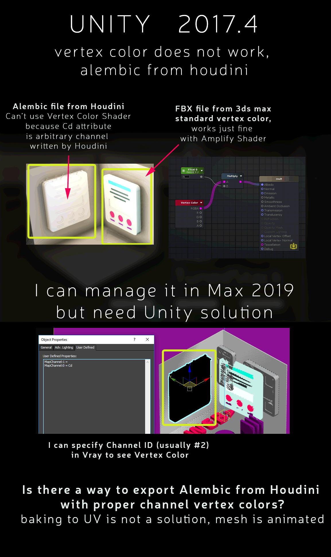

Is there a special Houdini shader for Unity that renders vertex colors?
I use Amplify Shader, it works perfectly fine with geometry exported from Max (Vertex Paint, channel_ID = 0)
But It does not work with Alembics exported from Houdini as Cd attribute is arbitrary (channel_ID = 1-2-3..N)
Yes, I can select a channel in 3ds max to render colors but not in Unity.
1. Is there a way to change the channel for imported ABC file in Unity?
2. Is there a correct way in Houdini to exporting Vertex Color to Unity (I can't find anything for months already)
3. Is there anything can be done on shader level? - like to select a channel_ID from the geo,
Amplify vertex color is RGBA only, no other settings available.

I've posted a git issue in Alembic for Unity repo,
https://github.com/unity3d-jp/AlembicForUnity/issues/210 [github.com]
the Author said it's definitely a Houdini alembic export issue.
so it is not #1_Unity_ALembic or #3_Shader_related issue
It all comes down to a proper Houdini export to Unity I assume.
It would be nice to know what export settings/ workflow to use in this case.

but I'd like to export Alembic .abc format (as I can export mesh animations)
For some reason alembic vertex color does not work directly but via channel somehow,
maybe I need to attribute promote or remap?
here is what unity alembic developer says:
https://github.com/unity3d-jp/AlembicForUnity/issues/210#issuecomment-440846343 [github.com]
for some cases new Houdini game tools are super helpful,
like I can export small solid body simulation animations via vertex shader textures,
but it's pretty limited (I can not change vertex scale, just the position)
If you can help with the Alembic SOP setup - that would be super awesome, there are tons of settings for sure,
