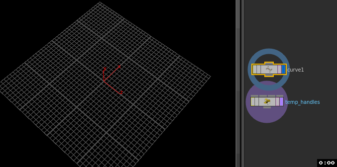

Or just make your own. Put this in a attrib wrangle in detail mode:
// first handle
int line = addprim(0, ‘polyline’);
addvertex(0,line, 0);
addvertex(0,line, 1);
// last handle
addvertex(0,line, @numpt);
addvertex(0,line, @numpt-1);
// the rest
for (int i=2; i<@numpt; i+=3) {
addvertex(0,line, i);
addvertex(0,line, i+1);
addvertex(0,line, i+2);
// first handle
// last handle
// the rest

mestela
// first handle
// last handle
// the rest
Thanks Mestela; your codes are awesome.

BabaJI am betting that is it. here is what i haveI am learning Houdini, I entered this but keep getting “i” as and undefined variable.
You likely inadvertantly made a typo…post your code if you still have problems.
// first handle
int line = addprim(0,'polyline');
addvertex(0,line,0);
addvertex(0,line,1);
//last handle
addvertex(0,line,@numpt);
addvertex(0,line,@numpt-1);
//the rest
for (int i=2;i<@numpt;i+=3);
addvertex(0,line,i);
addvertex(0,line,i+1);
addvertex(0,line,i+2);
found the error. I have semicolon before the { on for line
Edited by bobc4d - Oct. 13, 2018 10:59:29
