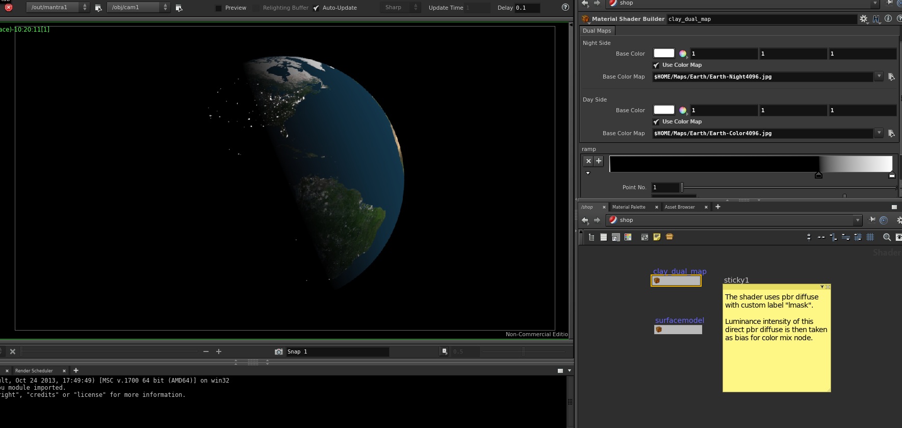

Here is a start. Basically I am trying to use a lighting model at the SHOP level to control the bias on a mix colors node. I have taken the X vector out of the direct lighting shadow socket to control the mix. This demonstrates that some kind of control can be achieved but it is far from complete.
I don't really know what math needs to happen to turn the direct lighting model in to a controller, preferably based off the spotlight falloff.
