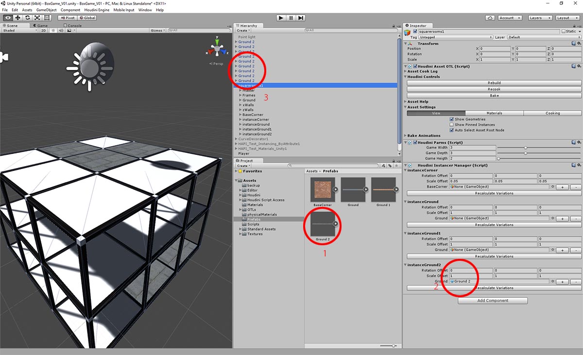

I try to make a game width different levels, so my thought was to make Prefabs out of my ground-objects. Also it makes a lot of Ground instances outside my object. See picture
I put a prefab (1) into Instance (2) brings a lot of Objects outside my Asset (3)
I can't find any way to bring a collider into my game. Inserting f.e. a box collider to my ground prefab deletes my objects.
I can't find the right point where to add textures and colliders -I'm sure it's my beginners mistake;o)

A couple things:
1. Do not try to make a Prefab out of the Houdini asset or any components from inside the asset by dragging them to the Project tab. This will break a lot of things. The only thing you can do with Houdini Assets and Prefabs is to bake a specific Houdini Asset state into a Prefab (as a whole).
2. There should be no need to set anything on the Houdini Instancer Manager (the way you dragged Ground2 under instanceGround2). You are already instancing Ground2 coming from Houdini. Those fields under each instancer are if you want to instance something from Unity instead of what is coming from Houdini.
3. To add collision meshes to your objects just put everything in a primitive group in Houdini called “rendered_collision_geo”.
4. Textures should come across if you assigned them to your SHOP shaders. Currently only Diffuse comes across though. Remember to first fix the problem mentioned in my previous post by assigning materials on the instances themselves and not just on the Instancer OBJ otherwise materials won't work at all.
