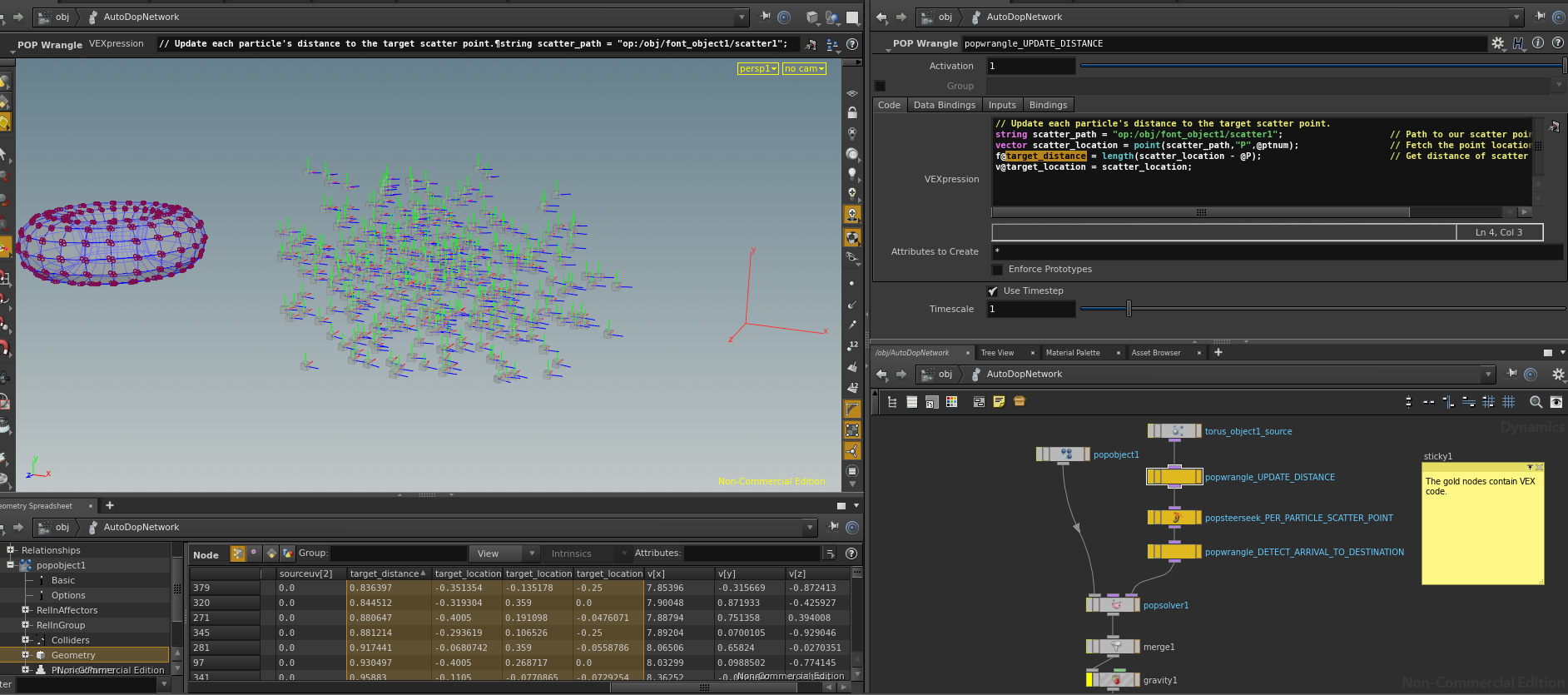

Here is an example of what I was thinking of.
The shape of the first pile is determined by the particle sourcing.
The shape of the second pile is determined by scatter points within a target geo.
The particle count and scatter point count are matched.
Every frame the VEX code runs and calculates a distance between each point and it's companion scatter target location.
When the distance between the point and target point is very small, velocity and force are set to zero.
To lock the particle into the final destination it's location is set to the target scatter location.
Use the Force Scale and Braking Distance values of the Pop Steer Seek to control how the particles approach the target shape.
