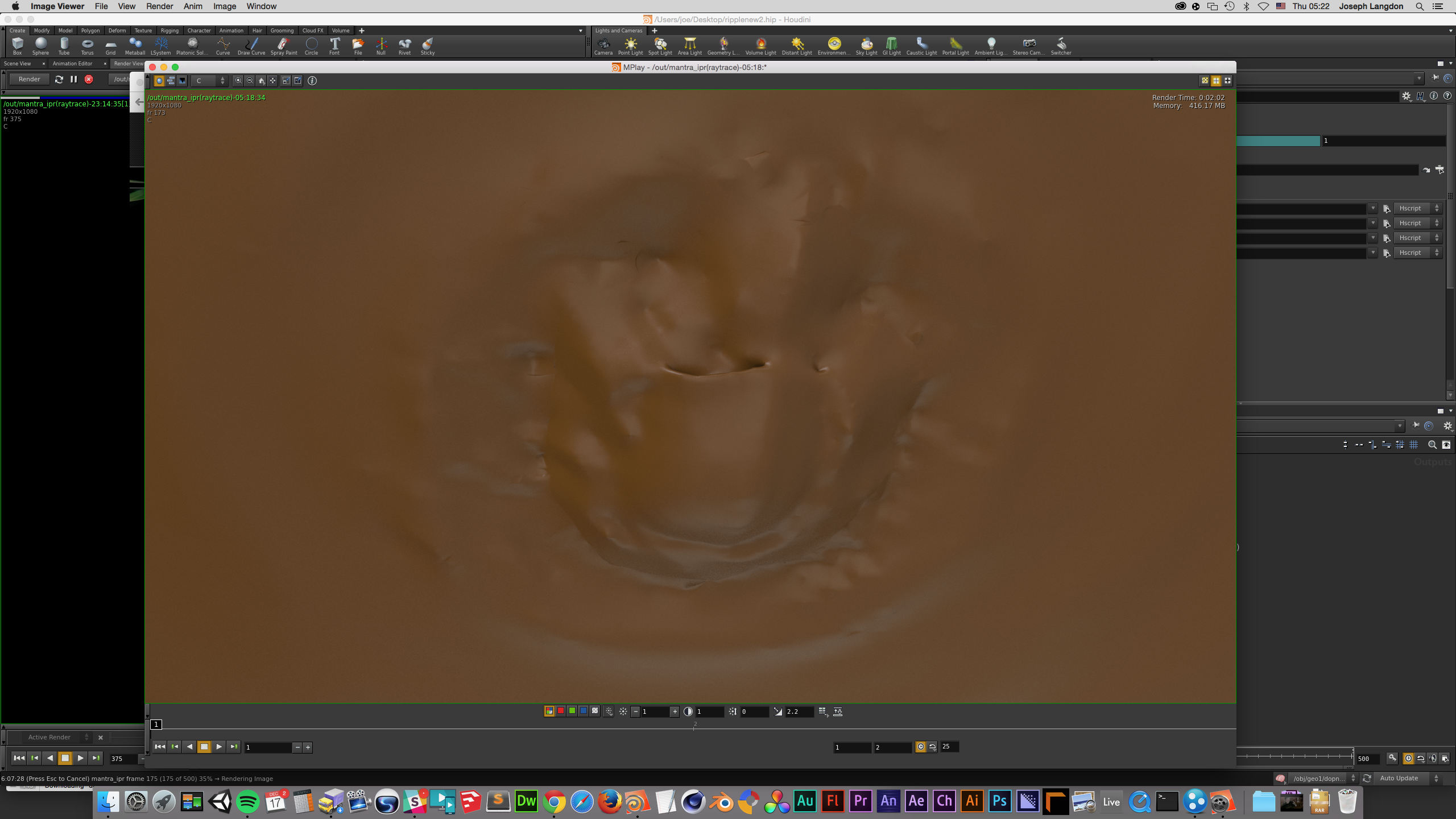

Just wondering if anyone out there has any tips on getting the ripples to disperse from the object. I have attached a version that works how I want but I really want the object that is passing through to interact with the ripples.
Here is what I have so far.

riple solver works with metaballs.
you could do a volume out of the head, scatter points and copy metaballs to it,
run a sim of those metaballs to a plane with the ripple solver
then just then, make a Dbd volume out of that, and then convert it back to polygons.
if you need velocity attribute for blur you can transfer it from the original simulation.
