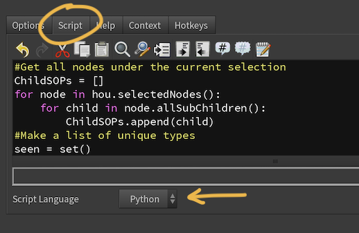

Okay here's how do it!
Right click in an empty part of a shelf and choose ‘New Tool’
Then go to the script section and paste the script in (it's at the bottom of this post).
Press ‘Accept’ on that and you should have a new toolbar button!
Now, select a bunch of nodes and press that button and you should get a dropdown of all the nodes within your selection
Choose one type and in the shared parameters should appear in your ‘Parameters’ Pane, ready for multi editing fun times

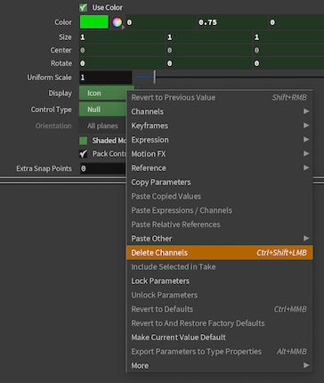

522 posts
Joined: Dec. 2013
Yeah that's the whole point of it. I did notice however that it was behaving a little unpredictably with Nulls.
I think it has to do with the parameters of the control nodes referencing the top level parameters of the null node. If I delete the reference it seems to multi edit fine.
But yeah, this has definitely saved me whenever I have to multi edit a bunch of nodes. Travelling into them one by one drives you nuts! Here's a little test, if I select this bunch of nodes and run it, then choose ‘Control’.
You can see in the parameter pane there are a bunch of nodes selected.
Oh, I realised I should have cleared the selection, I added a line to the script in the last post.
See how ya go!

506 posts
Joined: March 2014
peteski
See how ya go!
Ha, brilliant. After deleting the connection it works like a charm on Nulls as well.
This will save so much time and frustration. Thanks !
