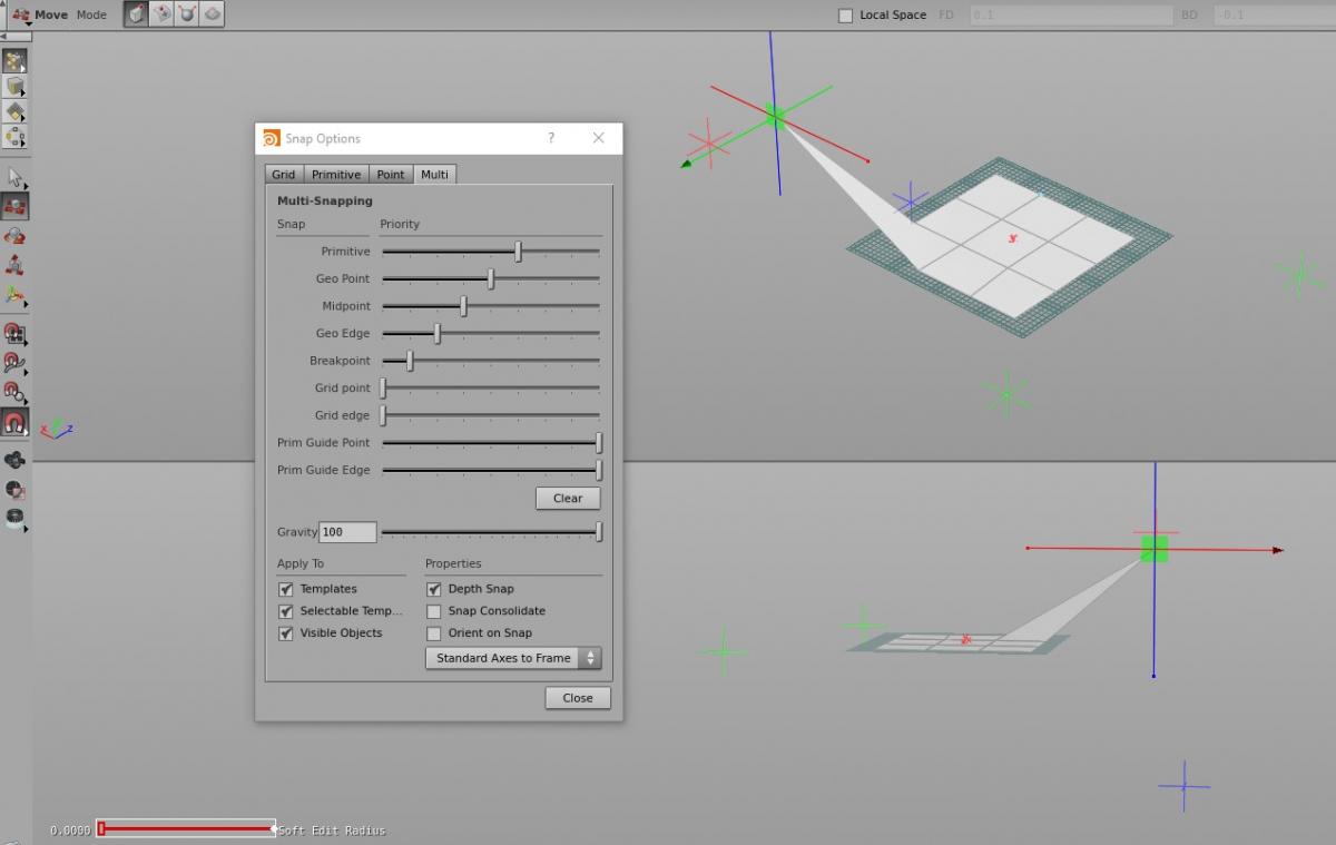

I can't not snap the point of a grid to a the red null ( or blue one, doesn't matter).
snapping to points doesn't work for me… and I think I'm doing something wrong.
copy and pasting the translating values from each null objects is not practical!.
might you please help me?
thank you in advance
