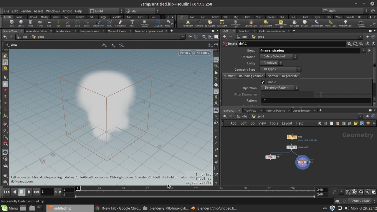

Blender 2.77 has OpenVDB caching for smoke and fire. Reading Blenders VDB works straightforwardly in houdini and displays nicely in Viewport. Other way around though will result in Blender crashing.
By comparing Spreadsheets and node information, the difference in data storing becomes evident. I figure a good place to start is to try to replicate variables that Blender uses.
First problem that I face is velocity being split into 3 components (vel.x , vel.y, vel.z ) and stored as floats while in Blender you have a velocity “group” stored as vec3. Is it possible to convert these 3 groups(vel.*) into 1(velocity, vec3)? e.g in ConvertVDB node would be nice to have Group: @name=density @name=heat @name=`velocity=vector(vel.x,vel.y,vel.z)` if that makes any sense.
All in all this forum is filled with bright minds. If anyone is up to the challenge, they can grab 2.77 Blender build and see if they can figure it out.
Any information, help is highly appreciated.
