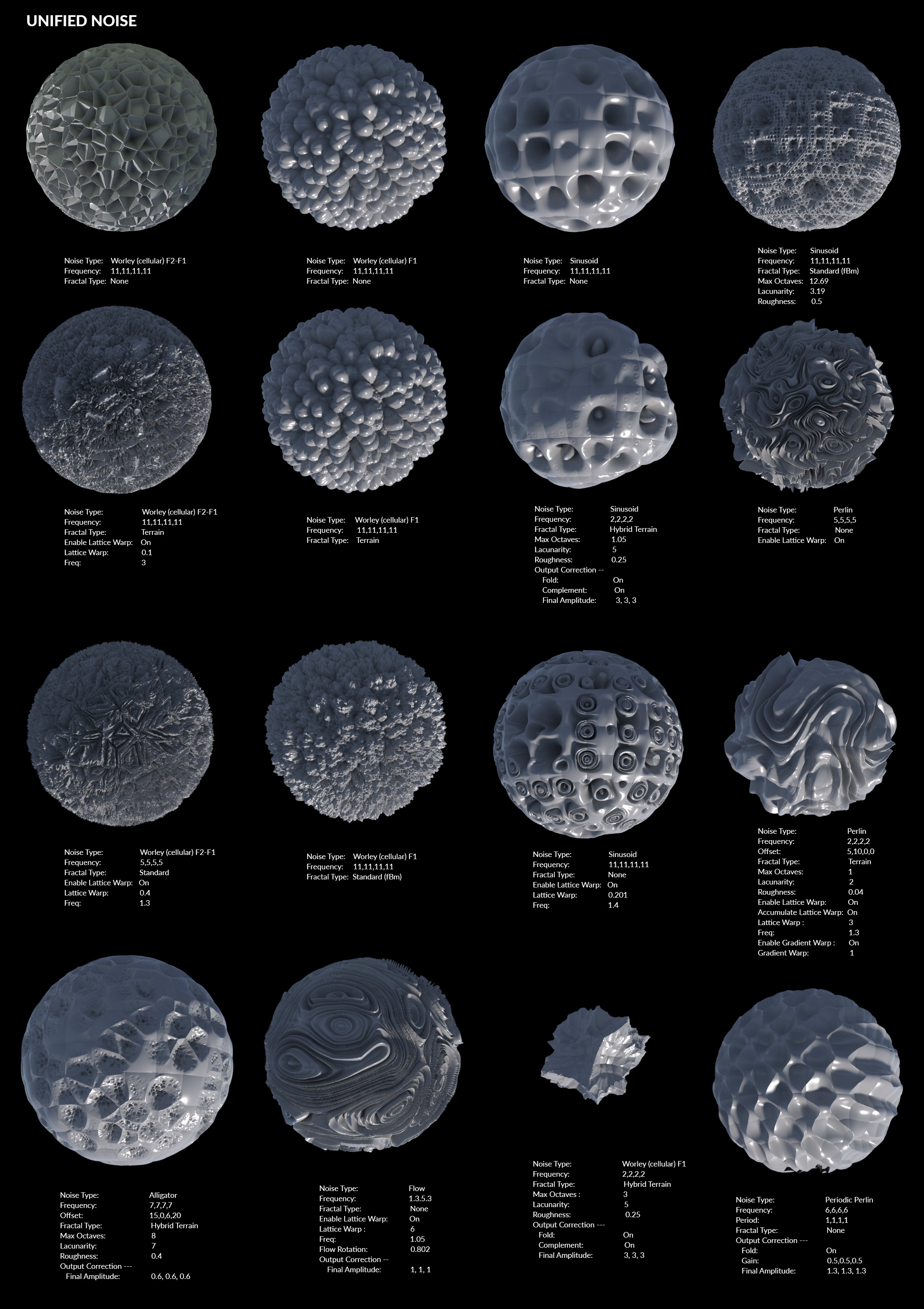

Hello! I was curious about the types of noises that you could use for displacement and thought it would be fun to have a sort of glossary of what those noises and fractal types would look like. I only picked out the ones I thought were visually interesting…
Anyway, just thought I would share
Setup: I just had a simple polygon sphere and threw on a principled shader, then used the Unified Noise to displace.
P.S. I initially tried to keep the noise types together in some sort of order but.. layout dictated differently
Edited by fianna - Aug. 21, 2016 10:30:23

Really nice! Would be awesome to see this in the documentation, with their .hip files too.

I see a flower, snow, a planet surface and bubble skin.

Um, wow….so that's some serious Noise there.
Would love to know how to bake these down for 3rd party rendering.

Very handy, thanks!
Just looked at that image on a laptop, the text is a bit too small to read. Any chance of a higher res image?
Ah, your updated image is much better, thanks.
Edited by mestela - Aug. 21, 2016 19:26:36

yes whats the point of posting it if it cant be read?

Hmm Patar/Matt - looks like my image got scaled down on the img upload site i put it on..
*argh.. i didnt want to put it as an attachment but it seems that all those image upload sites either resize your img or force you to go to their page
anyway..about including into docs, I can ask about that..but i dunno about the .hip files. I've marked down all the settings used to get each one, so you should get same look of displacement with those settings (hopefully i didnt forget to put some down in my excitement of "oooh that's a cool shape!").

Pretty neat fianna.
The image didn't get scaled down btw, it's just that the zoomed view won't let you see it at 1:1. If you open the image in a new tab you can view it at the proper size.
