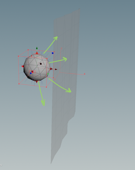

Hi All,
Just wondering if it's possible to apply a force to this cloth based on the normals of the sphere object behind it? I cant seem to find a force that might work based on the mesh shape.
Also the object won't always be sphere shaped so I can't use a basic force to achieve the same results.
Any ideas?
Thanks,
Pete

But isn't that essentially collision?
What if you add an exploded view to your source mesh and use the exploded parts for collision? They would project out along their normal.

Hehe, Yes I see what you mean
I was thinking something a little less solid than an actual collision. Is it possible to effect cloth with a particle system, maybe a velocity field?

I think a sop solver is the way to go and gives you the most flexibility. You just need to transfer the force ( or normals ) from the sphere to the cloth. You can also do some fancy pressure / underpressure imitation if you have a closed cloth object and use it's own normals as force.

Ha! Thanks blackpixel! That looks perfect, the pressure looks cool too
