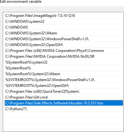

- axelsp
- 100 posts
- Joined: Sept. 2006
YES !! EVERYTHING CHECKS! From the Header to the module import! Thanks so much!
What would be the best solution for this tho, should I replace the “C:\Python27” entry on the os Path to point to houdini's? Bit reluctant on that, perhaps other things will start crashing (?)
C:\Program Files\Side Effects Software\Houdini 15.5.523\python27>set PATH=C:\Program Files\Side Effects Software\Houdini 15.5.523\bin;%PATH% C:\Program Files\Side Effects Software\Houdini 15.5.523\python27>python.exe Python 2.7.5 (default, Oct 15 2015, 15:22:58) [MSC v.1900 64 bit (AMD64)] on win32Type "help", "copyright", "credits" or "license" for more information. >>> import sys >>> sys.path['', 'C:\\Program Files\\Side Effects Software\\Houdini 15.5.523\\python27\\python27.zip', 'C:\\Program Files\\Side Effects Software\\Houdini 15.5.523\\python27\\DLLs', 'C:\\Program Files\\Side Effects Software\\Houdini 15.5.523\\python27\\lib', 'C:\\Program Files\\Side Effects Software\\Houdini 15.5.523\\python27\\lib\\plat-win', 'C:\\Program Files\\Side Effects Software\\Houdini 15.5.523\\python27\\lib\\lib-tk', 'C:\\Program Files\\Side Effects Software\\Houdini 15.5.523\\python27', 'C:\\Program Files\\Side Effects Software\\Houdini 15.5.523\\python27\\lib\\site-packages'] >>> sys.path.append("C:\\Program Files\\Side Effects Software\\Houdini 15.5.523\\houdini\\python2.7libs") >>> import hou [Redshift][core] Redshift for Houdini plugin version 2.0.86 [Redshift][core] Plugin compile time HDK version: 15.5.565 [Redshift][core] Houdini host version: 15.5.523 [Redshift][core] Plugin dso/dll and config path: CProgramData/Redshift/Plugins/Houdini/15.5.565/dso [Redshift][core] Core data path: C:\ProgramData\Redshift [Redshift][core] Local data path: C:\ProgramData\Redshift [Redshift][core] Procedurals path: C:\ProgramData\Redshift\Procedurals [Redshift][core] Preferences file path: C:\ProgramData\Redshift\preferences.xml [Redshift][core] License path: C:\ProgramData\Redshift [Robert Vinluan] GENIUS ! >>>
Edited by axelsp - March 1, 2017 06:27:16
- rvinluan
- 1283 posts
axelsp
That would be the simplest solution.
I would set PATH like so:
set PATH=C:\Program Files\Side Effects Software\Houdini 15.5.523\bin;C:\Program Files\Side Effects Software\Houdini 15.5.523\python27;%PATH%
I wouldn't worry about other things crashing because of this change. There's not a lot of libraries in the python27 folder that can cause library conflicts.
But switching to Houdini's python can potentially cause any 3rd-party Python modules that you've installed to stop working if those modules are compiled (i.e. are .pyd files) and compiled by a different compiler version. But that's a problem you would eventually hit anyway with or without setting the PATH variable.
Cheers,
Rob

Hay there everyone, I know this Thread is old but I am trying to get my Hou Module to work within Maya.
I am trying to get Maya to load a houdini hip file and run a render ROP.
If I am understanding correctly, setting this up should do the trick but I am not sure on that ?
I have followed this thread and get the following error after doing the import hou after launching python from inside the command Prompt and setting all the paths.
I have also tried Manually editing the Environment variables in Windows with no luck.
Any help Would be Greatly Appreciated.
File "", line 1, in
File "C:/Program Files/Side Effects Software/Houdini 18.5.351/houdini/python2.7libs\hou.py", line 32, in
import _hou
ImportError: DLL load failed: %1 is not a valid Win32 application.
