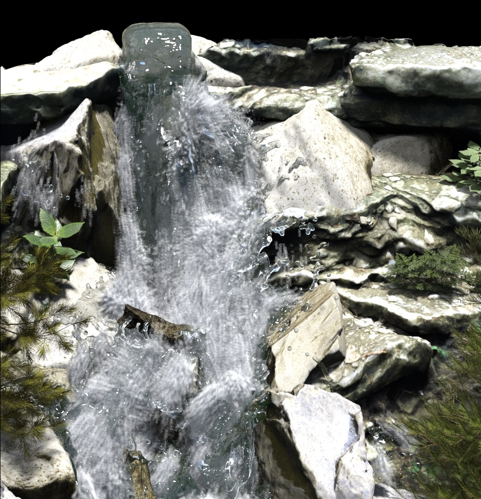

OK after playing around with it this seems to be the best result I am able to get, which is somewhat unsatisfactory. How do I get the results from this image which was done in Houdini? https://i.vimeocdn.com/video/496148453.jpg?mw=1920&mh=1080&q=70 [i.vimeocdn.com] The foam looks much better having spectacularity and actually floats on the surface of the fluid itself.
((Ignore the texture on the base of the model below which hasn't been UV mapped yet.))

The way I do it is very slow when rendering but it gives me the most satisfactory results as of now.
Render as small points, around 1 mm in radius, with a water-like reflection, no refraction, opacity around 0.15, faux caustics. Maybe add a little diffuse.
I'd be very glad to hear a faster approach.
*edit. Actually add a lot of diffuse, now that I'm checking.
Edited by A-OC - Feb. 13, 2017 18:32:16
253 posts
Joined: July 2006
It gets faster as I dial up the opacity but it also starts looking like sand.

253 posts
Joined: July 2006
Here's something I'm working on as we speak
Joined: Jan. 2017
Ah very nice. That is exactly what I'm after. So then I am replacing the Volume Rasterize Particles with a Point node? If so I'm not finding any option to change the particle size and they are quite huge when i go to render..
