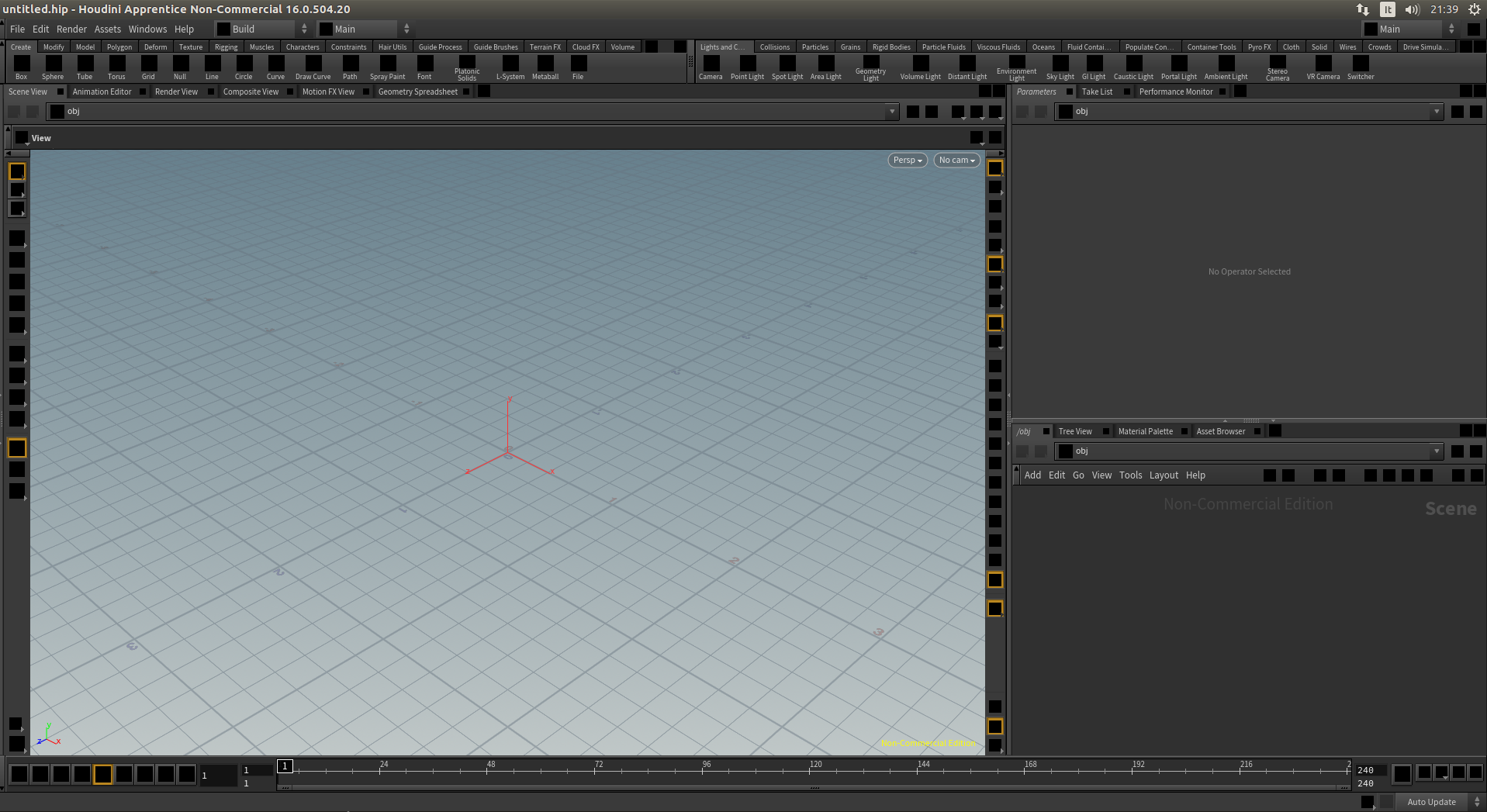

I install the apprentice of Houdini 16 and when I open it I have this error
File “<stdin>”, line 2, in <module>
File “/opt/hfs16.0.504.20/houdini/python2.7libs/sas/localassets.py”, line 1780, in ensure_webresponder_server_is_running
_web_responder_api = webresponder.start_server(WebResponderAPI)
File “/opt/hfs16.0.504.20/houdini/python2.7libs/sas/webresponder.py”, line 26, in start_server
logger = _create_logger()
File “/opt/hfs16.0.504.20/houdini/python2.7libs/sas/webresponder.py”, line 69, in _create_logger
hutil.file.ensureDirExists(sas.localassets.asset_store_dir())
File “/opt/hfs16.0.504.20/houdini/python2.7libs/hutil/file.py”, line 24, in ensureDirExists
os.makedirs(dir_path)
File “/usr/lib/python2.7/os.py”, line 157, in makedirs
mkdir(name, mode)
OSError: Permission denied: ‘/home/matevil/houdini16.0/asset_store’
and I see all icon black
I use Ubuntu 16.04, any ideas for fix it?
Thank you
Matteo
Screenshot from 2017-02-21 21-39-32.png (737.3 KB)
7899 posts
Try running this first prior to starting Houdini
mv ~/houdini16.0 ~/houdini16.0.old
This moves aside your preferences and gets Houdini to generate them again.
Edited by edward - Feb. 22, 2017 00:05:55
147 posts
Hi Edward,
thank you so much (again… I need to pay one beer if I meet you )… yes, now it's working
Matteo

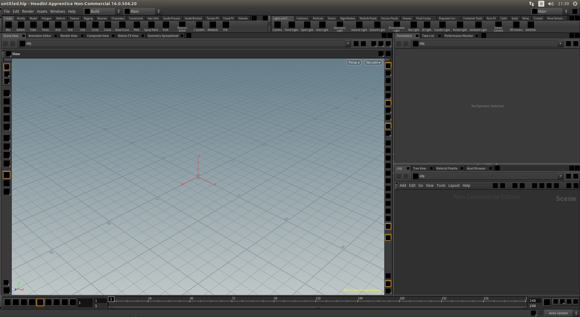

147 posts
mh…. Edward no beer yet
File “Mouse Event Handler”, line 18, in <module>
File “/opt/hfs16.0.504.20/houdini/python2.7libs/nodegraphselectpos.py”, line 24, in handleEvent
handler_coroutine.send(uievent)
File “/opt/hfs16.0.504.20/houdini/python2.7libs/nodegraphselectpos.py”, line 146, in handleEventCoroutine
snapresult = snap.snap(editor, None, rect, alignrects)
File “/opt/hfs16.0.504.20/houdini/python2.7libs/nodegraphsnap.py”, line 123, in snap
snapNodes(editor, item, rect, snaprects, currentsnaps, result)
File “/opt/hfs16.0.504.20/houdini/python2.7libs/nodegraphsnap.py”, line 145, in snapNodes
radius = utils.getSnapRadius(editor)
File “/opt/hfs16.0.504.20/houdini/python2.7libs/nodegraphutils.py”, line 261, in getSnapRadius
return prefs.snapRadius(editor)
File “/opt/hfs16.0.504.20/houdini/python2.7libs/nodegraphprefs.py”, line 248, in snapRadius
return float(editor.getPref(theSnapRadiusPref))
ValueError: invalid literal for float(): 0,100000
Screenshot from 2017-02-22 10-56-08.png (280.7 KB)

7899 posts
As a workaround, set this environment variable prior to starting Houdini
export LC_ALL=C
Edited by edward - Feb. 22, 2017 09:17:18
Joined: April 2015
Or put it in the houdini.env :
LC_ALL=C
2641 posts
We hope this issue will be fixed in the next daily build.
