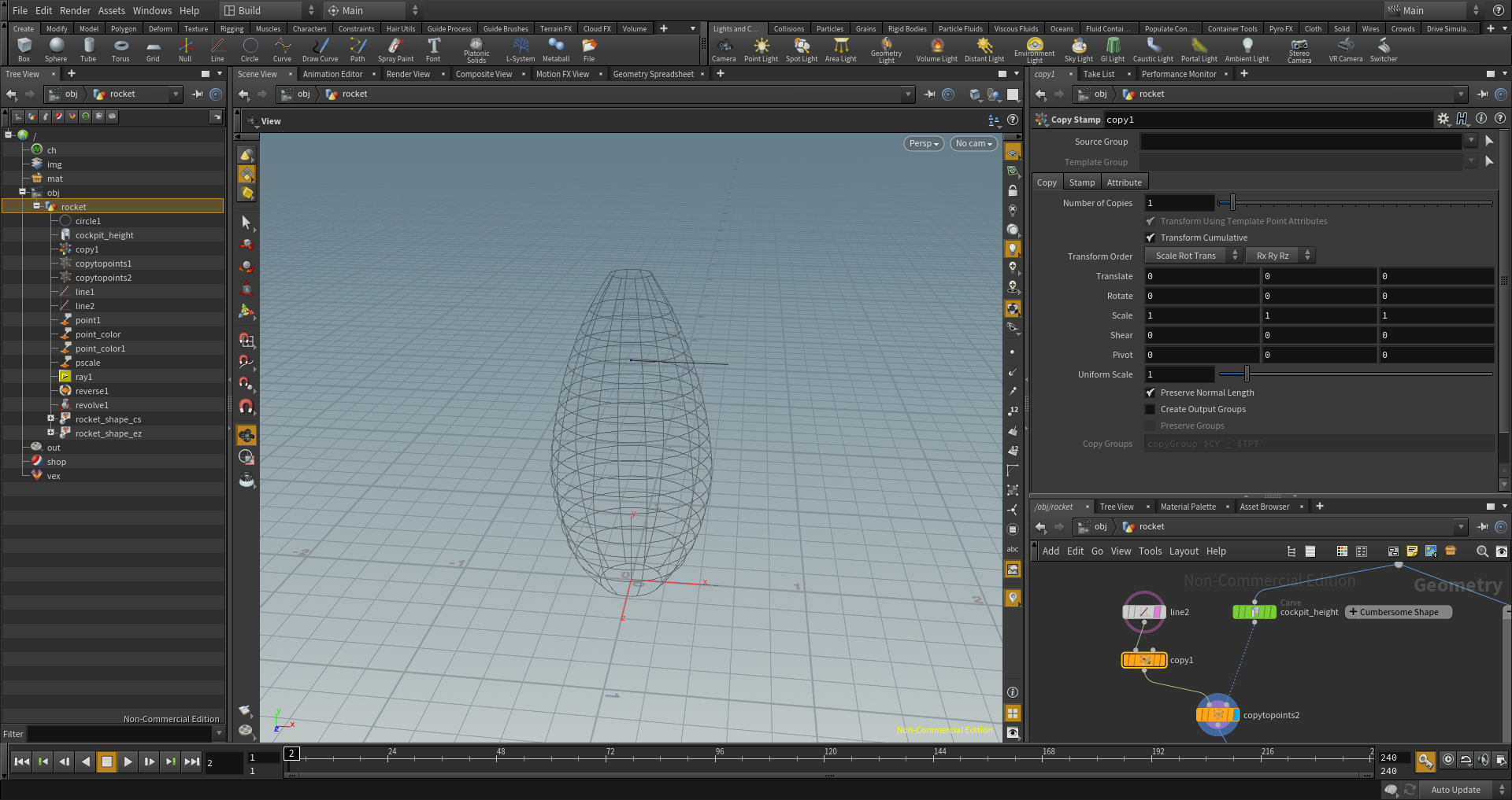

Now I already figured out that Rohan is using an older group node that is obsolete and should not be used anymore, but I can't really figure out what node to use and how to get the same effect. It's very simple, I basically need to create the settings as seen in the attachment. (Create a Group with “top” as Group Name, Points as Entity and a Pattern of 1.)

All the group node is doing in Rohan's example is selecting point # 1, and naming it top. In h16 if you drop the new group node you'll see a base group field, you can type 1 there (and change group type to points), and it will do the same thing as the old group.
Another tip, anytime you drop a node and it lets you choose a group, usually at the top, you can enter a pattern directly, pattern is just the points/primitives numbers, ie type “1-10” and houdini will automatically create a group base on the group type.
