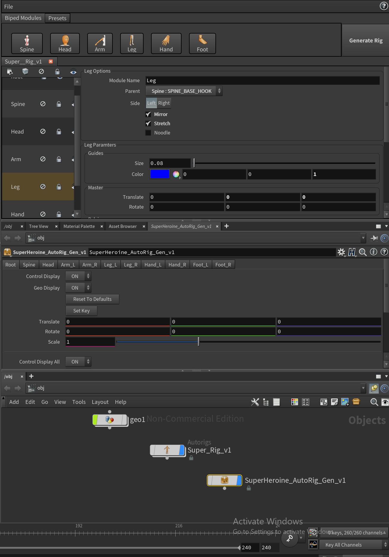

I've been following the various troubleshooting posts from 2017 regarding issues with Autorig.
I was wondering if someone could help me understand the tetrahedralize error
When I dive into Geo_Skin to bake:
Error
Invalid source /obj/Woman1/geo_skin/solidconform/tetrahedralize
Error: Invalid Max Size constraint (can't be 0)..
I cannot find any information about this error.
Would be great to get help troubleshoot this. Here are images to illustrate my process
thank you
