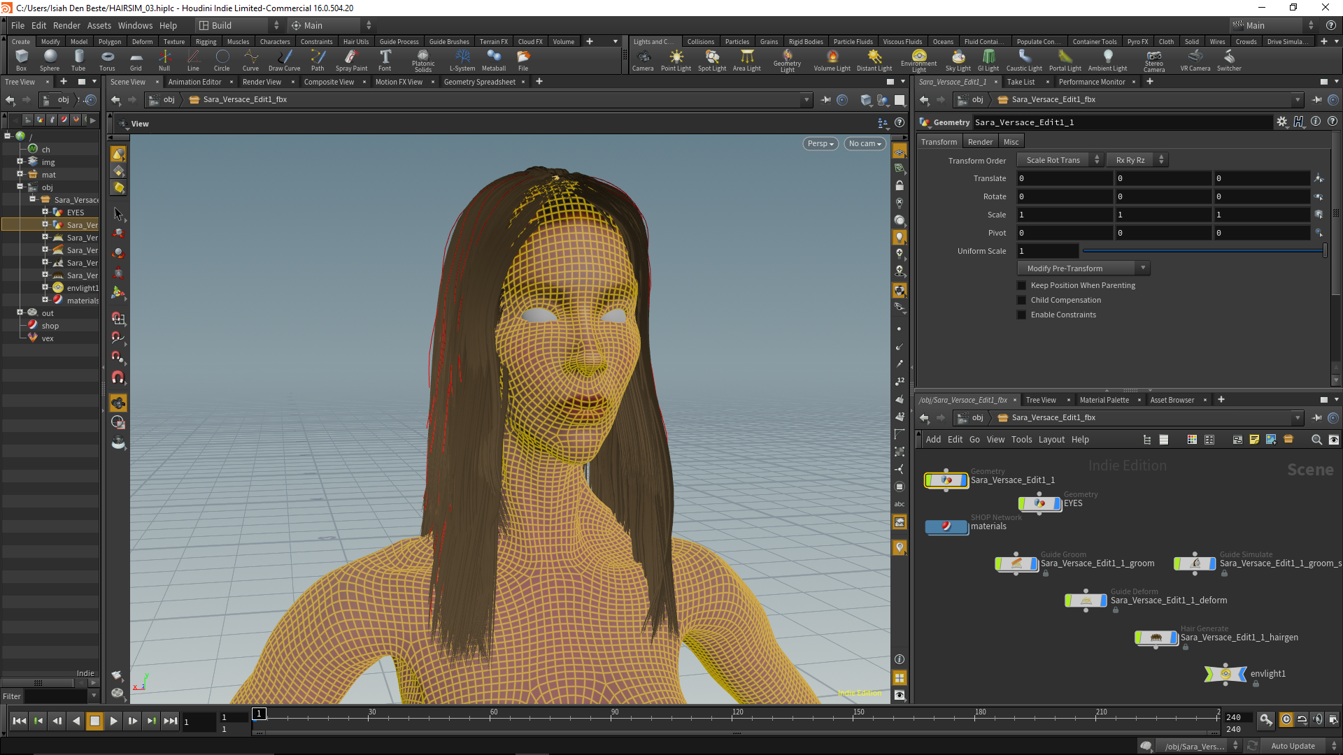

Hello, I have a groomed look and sim I am liking and wanting to use in Maya. When I export as Alembic it looks like the Sim and “guides” are in there nicely, but I don't actually see the hair_gen density etc. How do I convert the hair_gen stuff into GEO that I can export out? Thanks

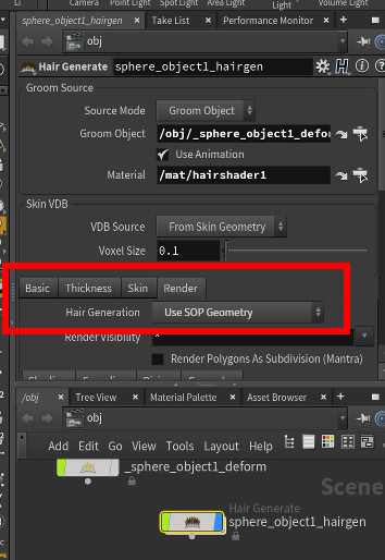

I am also having this problem. Did this work? If it did, where is the Render tab that links to the Hair Generation where I can change it to the SOP Geometry?
818 posts
Joined: Sept. 2013
The parameter is on the hairgen object. I've attached a screenshot showing where the parameter is.
