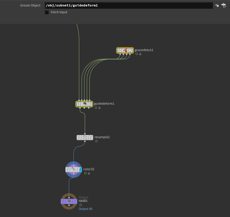

Joined: July 2017
I found solution that allows to workaround this issue a bit. It only work's with deforming guides not with simulated. In the hair generate node just go for guide deform node at the end of your setup, it seems to keep fractal clumping together.
