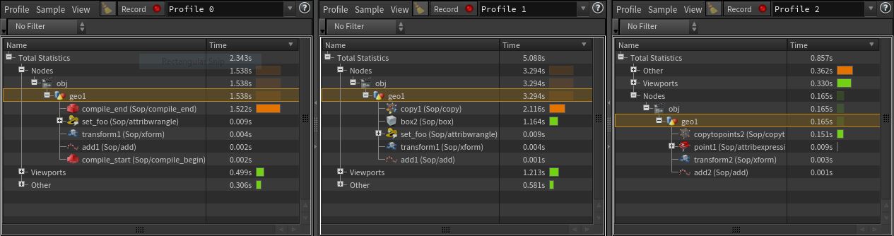

If you do trivial operations, then stamping can still be fast, but if you actually do something where parallelizing matters, then you can see massive gains. Also, stamping transformations is a bad example, since the copy to points will handle that orders of magnitude faster. I have yet to find a test case where the compiled for loop version is slower than alternatives, excluding stamping transforms with copy to points, or using vex parallelism (modify all data at once.)

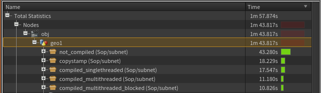

This are my results from that new Scene
the new block example Jeff added it's almost exactly the same as the stamp version, which is nice cause I like the stamp way, used to that and the new way is a little complex for new people.
So what's the magic ingredients that makes it faster?
this is on a 32 threads machine

A hard problem with multithreading is picking “grain size”. This is the size of the amount of work you run on each task. If you make the work too small, like adding two numbers together, you'll spend all your time in task management and end up way, way, slower. So whenever you multithread in C++ you always have to think about grainsize and ensure small datasets are batched together.
It is sort of like submitting jobs to a render farm. If your frames get short enough, it can become necessary to render 10 frames at once per job rather than each frame individually.
The problem is that we have no idea from the outside what the size of your contained network is. If it is a big chunk of work, the task scheduling won't show up and you should see nice scaling. But with really simple examples the opposite happens.
What I have done in that example is manually batch 256 points at a time. With the given point counts, this also means only 6 threads really become active, saving your 32 thread machine from tripping over itself for no benefit.
That said, I will be looking closer at this high-thread behaviour. Currently the point() function has an unnecessary lock in this example that could also be responsible for things locking up.
I've submitted Bug: 82242 to track this.
