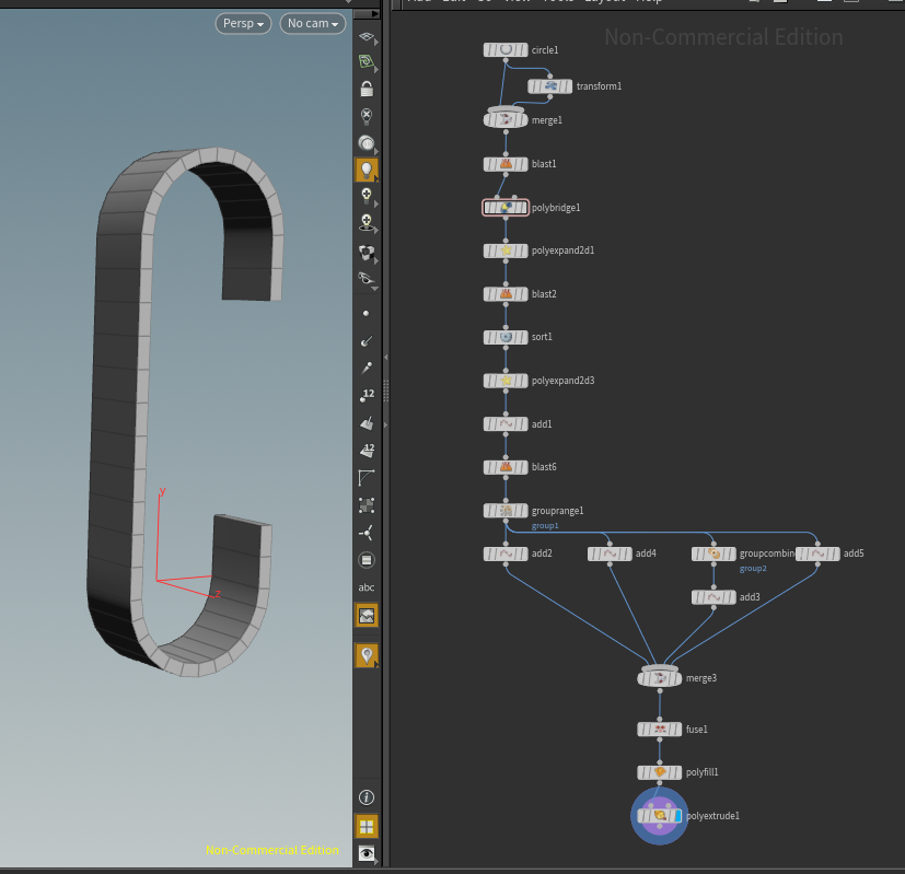

I modeled what I thought would be a relatively simple shape. However, the number of steps seems…extreme? It feels convoluted. Is my approach completely backward? Is there a better way? I'd love to see how you would model it.

depending on what you're tying to do I'd say yes.

how about:
1. grid
2. bevel
3. dissolve
4. polyexpand2d
5. polyextrude
