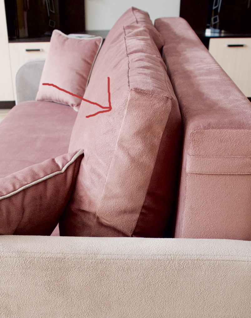

Greetings.
how to model such a pillow in houdini? which nodes is better to use? mountain sop works bad. help!!!

Are you talking about physically modeling in all those little details? Why not try out displacements?

I need both, but now i need physical modeling. how to make it look real. not like a box.

I think you should check this as you'll be working basically with noises:
https://vimeo.com/75313908 [vimeo.com]

guys is it possible in houdini to make such a material?

noise.

Konstantin thanks for file. it is all white. what to do to make it my color?

Go to mat/materialbuilder, dive inside, click on pbrdiffuse and change the color field. also play around with the diffuse roughness value on the same node.

Thank you Konstantin! I am trying to make this material for 2 weeks. in photoshop, substance designer, painter and other programs. as i see it is not about software
