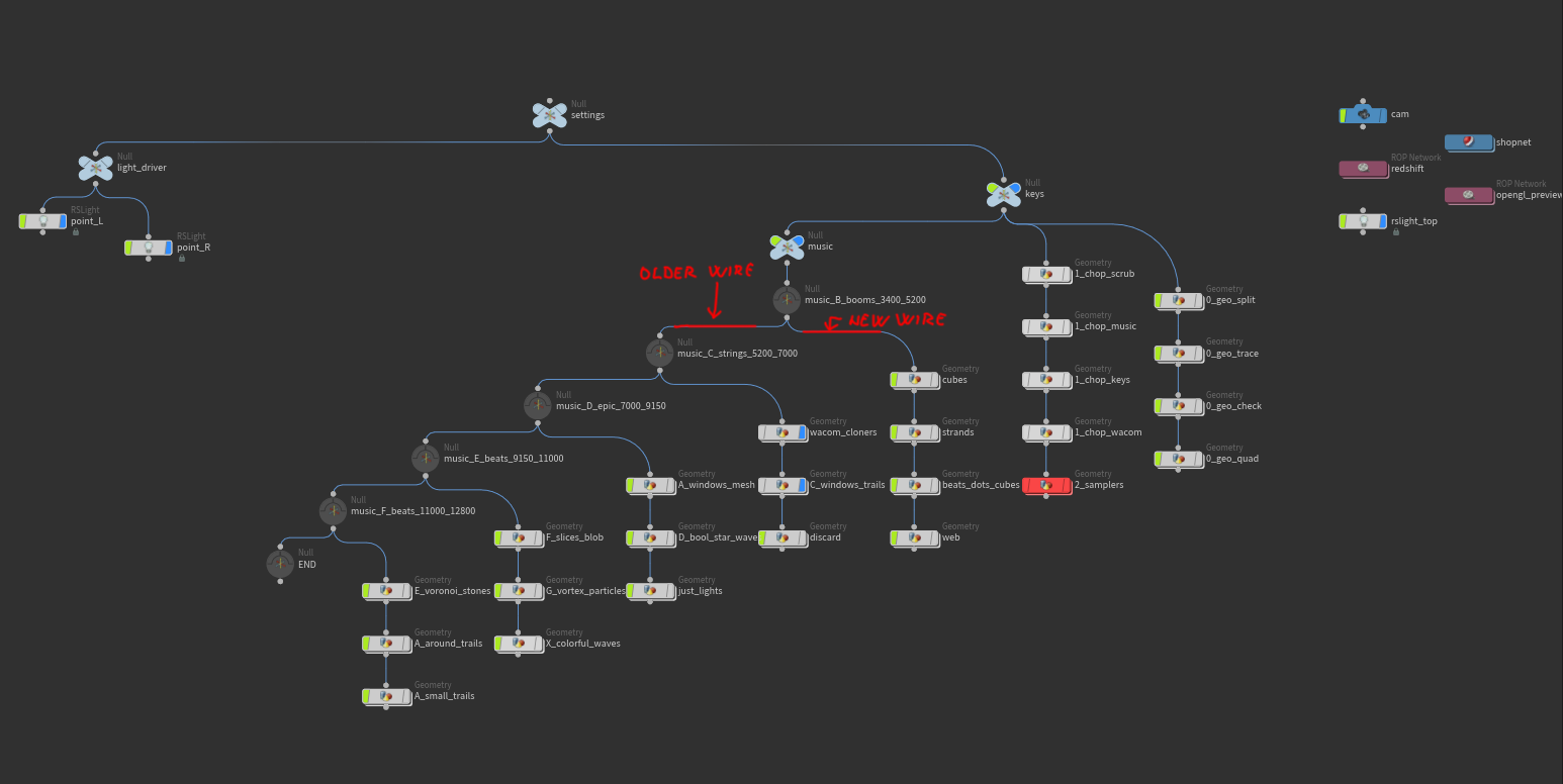

Now I am trying to make system in organizing my /obj level. I am almost satisfied, but it behaves inconsistent:
- when working with the file: children with “newer wire” jump to the right
- after save quit reopen: other sort logic is used, probably node “Created” date and time?
Does anybody know, how this system works, please? Probably SESI could unify it? Or could I write small python script and hack/set “Created” time alphabeticaly?
