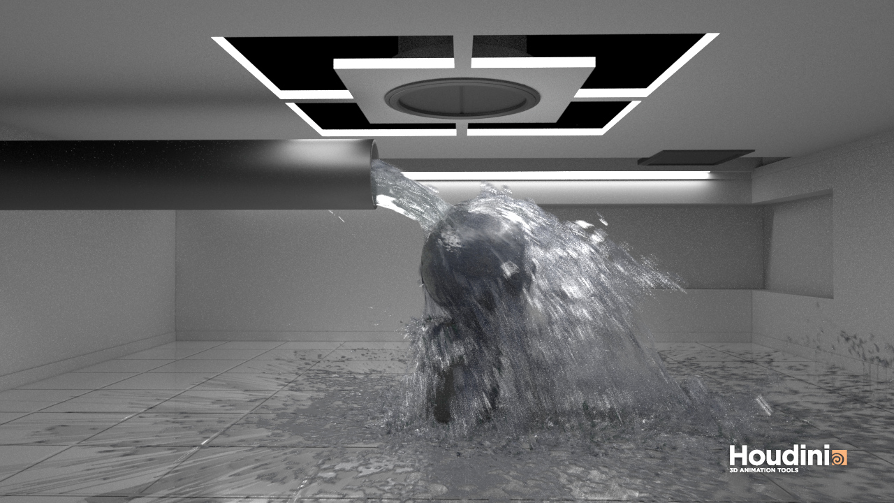

Can you please help me troubleshoot this scene, it's taking almost 6 hours to render per frame and there's still a lot of noise.
https://we.tl/3OxNKLPf8w [we.tl]
I'm using 16.0.541 i7-6800k 3.4 ghz 32 gb ram
Thanks.

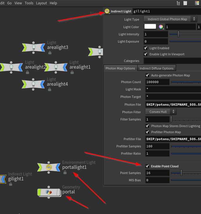

try to use this Enable Point Cloud for reduce noise and create a portal light from geo to minimize your rays from GI light, it will give you only rays from this portal geo.
ps, btw in your scene there isnt a wall)

Thanks, that point cloud check box really speeds things up. BUT, big BUT, it makes the water behave very strangely, I tried a lot of combinations with parameters to no avail. I went up to 10 million photons in 1 test. I also tried the classic and the principled shader instead of the basic liquid. Please watch the attached attempts.
The walls are in the geometry “walls” node, also there is a front wall set to phantom “box_coll” , it's just a scaled box.
