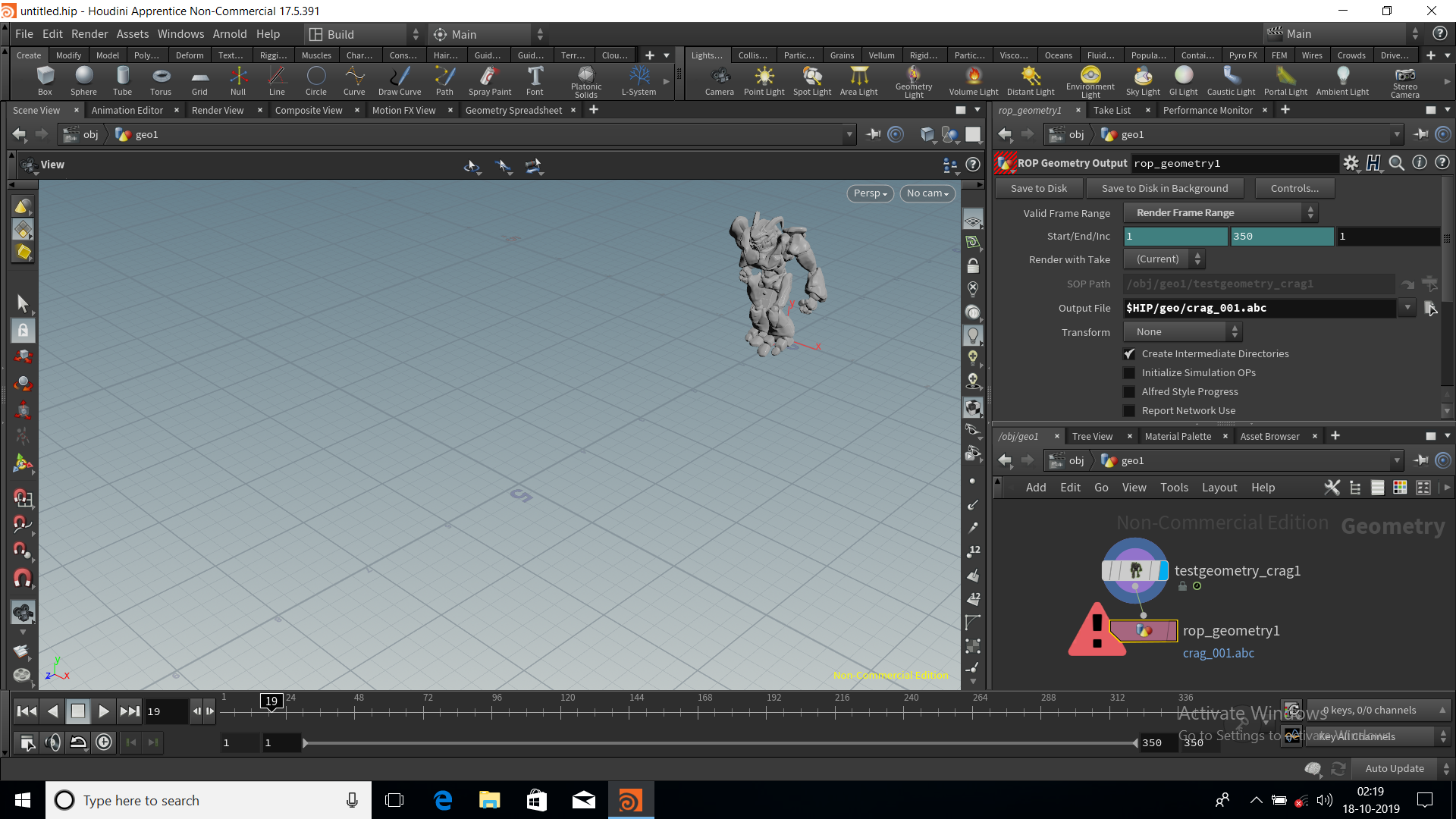

i just created animation using digital asset inside houdini 16. But i want to export animation to another package using (fbx or alembic). i keep getting weird result when exporting this animation in alembic some geometry jump to another position and fbx missing part of the asset.Please can you check this file and help me if there is any problem.

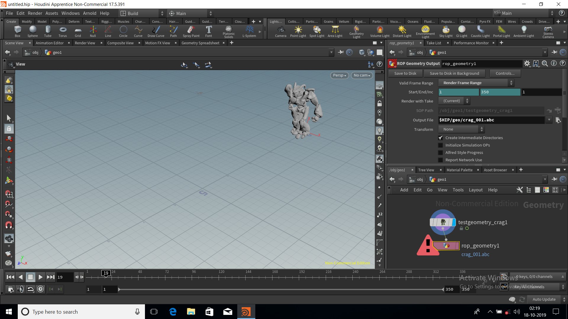

You cannot export any non Houdini native formats in Houdini Non-Commercial.
