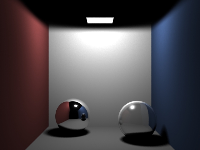

If you're using that shader I posted in the Cornell thread at odForce, you should disconnect the inputs to “maxcont” for both the reflected and refracted light VOPs – it tries to help out the renderer, but breaks down when going through “shells” instead of solid objects – and set their values explicitly to 1.
I'm attaching a revised version of that Cornell file. And here are some shell results (which you can compare to the solid versions posted at odForce)… and as mentioned, disregard the solid shadow…
