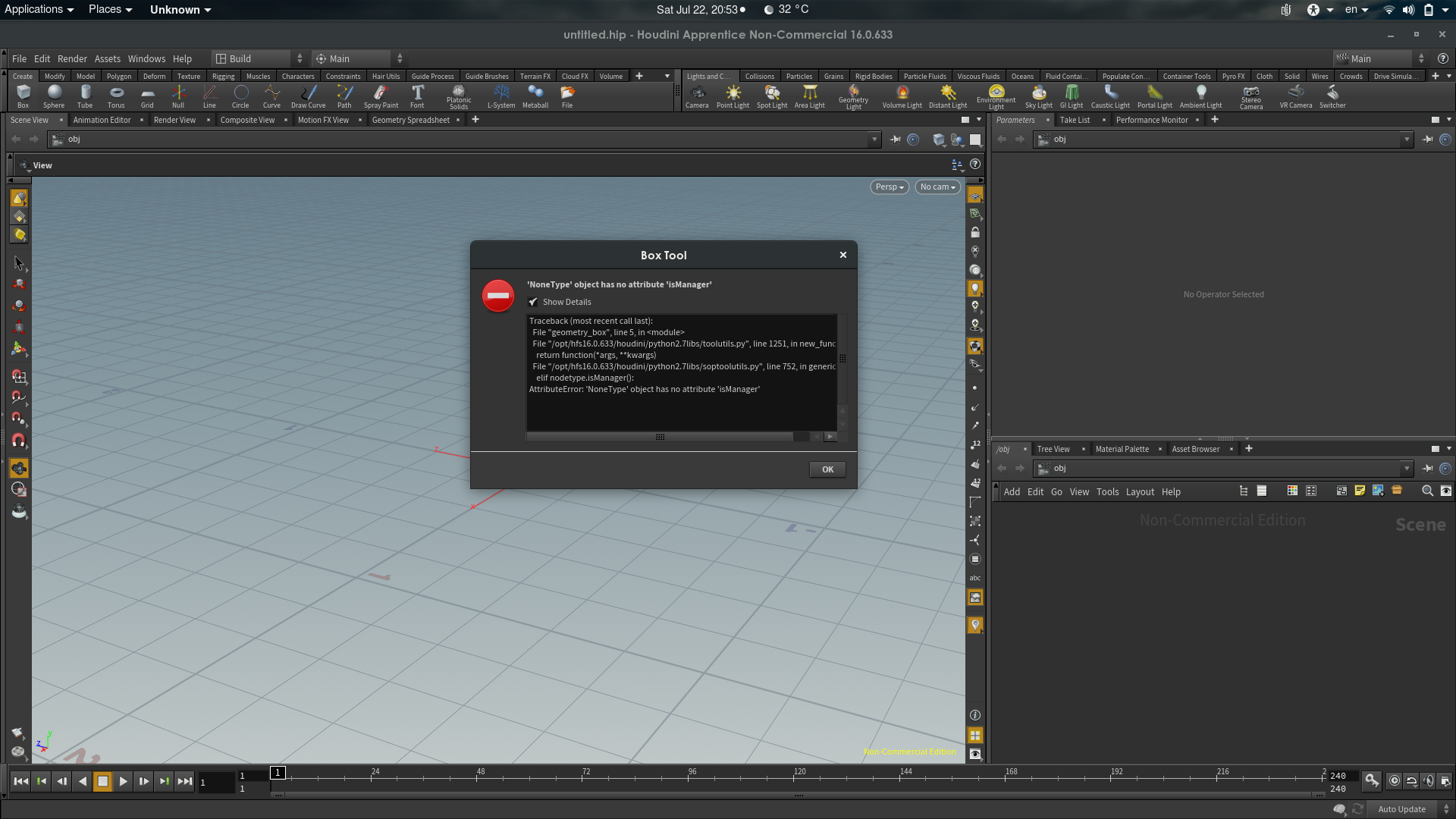

Hi all,
It seems I also cannot run Houdini on Fedora 26. I try both production build 671 and 633, and they are fails.
Below the crash logs.
And when I tried to run with Bumblebee Optimus, I've got the following,
Any help would be appreciated. Thank you
Crash report from aditia; Unknown App Version 16.0.671 [linux-x86_64-gcc4.8] Uptime 0 seconds Tue Aug 1 20:57:56 2017 Caught signal 11 Traceback from 15232 ThreadId=0x7f61643d2d00 AP_Interface::coreDumpChaser(UTsignalHandlerArg) <libHoudiniUI.so> AP_Interface::si_CrashHandler::chaser(UTsignalHandlerArg) <libHoudiniUI.so> signalCallback(UTsignalHandlerArg) <libHoudiniUT.so> UT_Signal::UT_ComboSignalHandler:perator()(int, siginfo*, void*) const <libHoudiniUT.so> UT_Signal::processSignal(int, siginfo*, void*) <libHoudiniUT.so> __funlockfile <libpthread.so.0> je_arena_dalloc_bin_locked (arena.c:1897) je_tcache_bin_flush_small (tcache.c:127) je_tcache_event_hard (tcache.c:39) PyList_Sort <libpython2.7.so.1.0> PyTuple_Size <libpython2.7.so.1.0> PyEval_EvalFrameEx <libpython2.7.so.1.0> PyEval_EvalCodeEx <libpython2.7.so.1.0> PyEval_EvalFrameEx <libpython2.7.so.1.0> PyEval_EvalCodeEx <libpython2.7.so.1.0> PyEval_EvalFrameEx <libpython2.7.so.1.0> PyEval_EvalCodeEx <libpython2.7.so.1.0> PyEval_EvalFrameEx <libpython2.7.so.1.0> PyEval_EvalCodeEx <libpython2.7.so.1.0> PyEval_EvalFrameEx <libpython2.7.so.1.0> PyEval_EvalCodeEx <libpython2.7.so.1.0> PyFloat_FromDouble <libpython2.7.so.1.0> PyObject_Call <libpython2.7.so.1.0> PyCode_New <libpython2.7.so.1.0> PyObject_Call <libpython2.7.so.1.0> PyWeakref_NewRef <libpython2.7.so.1.0> PyType_IsSubtype <libpython2.7.so.1.0> PyObject_Call <libpython2.7.so.1.0> PyEval_EvalFrameEx <libpython2.7.so.1.0> PyEval_EvalCodeEx <libpython2.7.so.1.0> PyFloat_FromDouble <libpython2.7.so.1.0> PyObject_Call <libpython2.7.so.1.0> PyCode_New <libpython2.7.so.1.0> PyObject_Call <libpython2.7.so.1.0> PyAST_obj2mod <libpython2.7.so.1.0> PyCode_NewEmpty <libpython2.7.so.1.0> PyMapping_HasKeyString <libpython2.7.so.1.0> PyNumber_Or <libpython2.7.so.1.0> PyEval_EvalFrameEx <libpython2.7.so.1.0> PyEval_EvalCodeEx <libpython2.7.so.1.0> PyEval_EvalCode <libpython2.7.so.1.0> PyImport_ExecCodeModuleEx <libpython2.7.so.1.0> PyImport_ExecCodeModuleEx <libpython2.7.so.1.0> Py_InitModule4_64 <libpython2.7.so.1.0> PyImport_ImportModuleLevel <libpython2.7.so.1.0> _Py_Mangle <libpython2.7.so.1.0> PyObject_Call <libpython2.7.so.1.0> PyEval_CallObjectWithKeywords <libpython2.7.so.1.0> PyEval_EvalFrameEx <libpython2.7.so.1.0> PyEval_EvalCodeEx <libpython2.7.so.1.0> PyEval_EvalCode <libpython2.7.so.1.0> PyImport_ExecCodeModuleEx <libpython2.7.so.1.0> PyImport_ExecCodeModuleEx <libpython2.7.so.1.0> Py_InitModule4_64 <libpython2.7.so.1.0> PyImport_ImportModuleLevel <libpython2.7.so.1.0> _Py_Mangle <libpython2.7.so.1.0> PyObject_Call <libpython2.7.so.1.0> PyEval_CallObjectWithKeywords <libpython2.7.so.1.0> PyEval_EvalFrameEx <libpython2.7.so.1.0> PyEval_EvalCodeEx <libpython2.7.so.1.0> PyEval_EvalCode <libpython2.7.so.1.0> PyImport_ExecCodeModuleEx <libpython2.7.so.1.0> PyImport_ExecCodeModuleEx <libpython2.7.so.1.0> _PyImport_LoadDynamicModule <libpython2.7.so.1.0> Py_InitModule4_64 <libpython2.7.so.1.0> PyImport_ImportModuleLevel <libpython2.7.so.1.0> _Py_Mangle <libpython2.7.so.1.0> PyObject_Call <libpython2.7.so.1.0> PyEval_CallObjectWithKeywords <libpython2.7.so.1.0> PyEval_EvalFrameEx <libpython2.7.so.1.0> PyEval_EvalCodeEx <libpython2.7.so.1.0> PyEval_EvalCode <libpython2.7.so.1.0> PyImport_ExecCodeModuleEx <libpython2.7.so.1.0> PyImport_ExecCodeModuleEx <libpython2.7.so.1.0> Py_InitModule4_64 <libpython2.7.so.1.0> PyImport_ImportModuleLevel <libpython2.7.so.1.0> _Py_Mangle <libpython2.7.so.1.0> PyObject_Call <libpython2.7.so.1.0> PyEval_CallObjectWithKeywords <libpython2.7.so.1.0> PyEval_EvalFrameEx <libpython2.7.so.1.0> PyEval_EvalCodeEx <libpython2.7.so.1.0> PyEval_EvalCode <libpython2.7.so.1.0> PyImport_ExecCodeModuleEx <libpython2.7.so.1.0> PyImport_ExecCodeModuleEx <libpython2.7.so.1.0> Py_InitModule4_64 <libpython2.7.so.1.0> PyImport_ImportModuleLevel <libpython2.7.so.1.0> _Py_Mangle <libpython2.7.so.1.0> PyObject_Call <libpython2.7.so.1.0> PyEval_CallObjectWithKeywords <libpython2.7.so.1.0> PyEval_EvalFrameEx <libpython2.7.so.1.0> PyEval_EvalCodeEx <libpython2.7.so.1.0> PyEval_EvalCode <libpython2.7.so.1.0> PyImport_ExecCodeModuleEx <libpython2.7.so.1.0> PyImport_ExecCodeModuleEx <libpython2.7.so.1.0> _PyImport_LoadDynamicModule <libpython2.7.so.1.0> Py_InitModule4_64 <libpython2.7.so.1.0> PyImport_ImportModuleLevel <libpython2.7.so.1.0> _Py_Mangle <libpython2.7.so.1.0> PyEval_EvalFrameEx <libpython2.7.so.1.0> PyEval_EvalCodeEx <libpython2.7.so.1.0> PyEval_EvalCode <libpython2.7.so.1.0> PY_CompiledCode::evaluateUsingDicts(PY_Result::Type, void*, void*, PY_Result&) const <libHoudiniUT.so> PY_CompiledCode::evaluate(PY_Result::Type, PY_Result&) const <libHoudiniUT.so> PYrunPythonStatements(char const*, PY_EvaluationContext*) <libHoudiniUT.so> PYrunPythonStatementsAndExpectNoErrors(char const*, char const*, PY_EvaluationContext*) <libHoudiniUT.so> BR_HelpManager::initializeHelpServer() <libHoudiniUI.so> BR_HelpManager::BR_HelpManager(bool) <libHoudiniUI.so> FUSE_HelpManager::FUSE_HelpManager(FUSE_App&) <libHoudiniAPPS3.so> FUSE_App::FUSE_App(char const*) <libHoudiniAPPS3.so> FUSE_HoudiniBinariesApp::createApplication(int&, char const**) <libHoudiniAPPS3.so> OPUI_MainApp::initApplication(UI_Manager*, int, char const**) <libHoudiniAPPS2.so> main <libHoudiniUI.so> __libc_start_main <libc.so.6> _start <houdini-bin>
/opt/hfs16.0/bin/houdini-bin: relocation error: /opt/hfs16.0.671/dsolib/Qt_plugins/xcbglintegrations/libqxcb-glx-integration.so: symbol _Z20QT_XCB_GLINTEGRATIONv, version Qt_5_PRIVATE_API not defined in file libQt5XcbQpa.so.5 with link time reference

varomix
To solve that python issue I set Houdini to use the internal python version instead of Fedora version
like this in the houdini.env file
HOUDINI_USE_HFS_PYTHON=1
varomix
Tnx Varomix very useful tip!!
