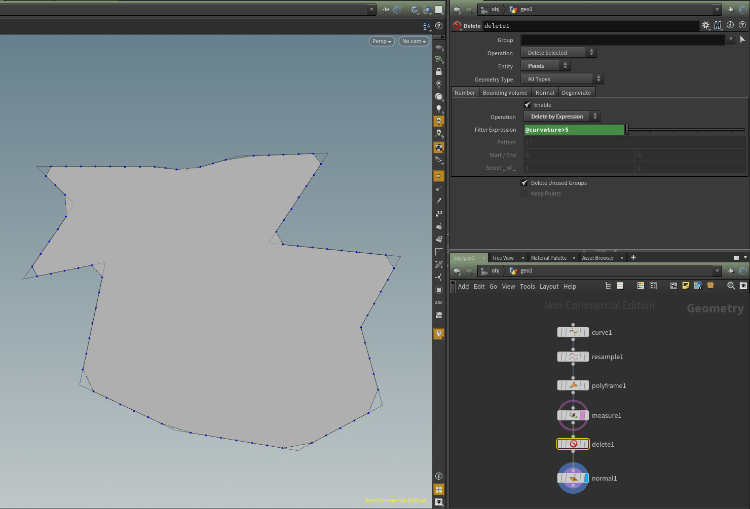

555 posts
easiest way is to add Measure>Curvature.
Then Delete, Points, Delete by Expression: @curvature>5 (or whatever you see fit)
Points in a straight line would naturally have curvature = 0 so won't be deleted
Edited by vusta - Oct. 24, 2017 23:48:58
vu_CornerCurv.hipnc (59.0 KB)
