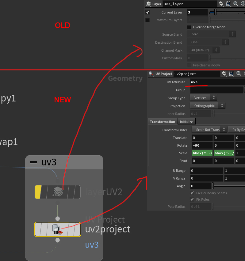

I have uv, uv2 and uv3 attributes on my mesh, in houdini 16.0.736 I was able to use layer node and change
the current layer and then the uv layers/sets would change in uv view. the layer node does atm nothing
in Houdini 16.5.268, is this a bug or is there some new workflow?

“With the new built-in support for multiple texture attributes, the Layer SOP is now deprecated. If you were using it to swap other attributes, use Attribute Swap instead.”
5211 posts
There's a menu in the UV viewport which replaces the useless camera menu that was there in 16.0, and you can select the uv attribute to view from it (among other things). Much easier than adding Layer SOPs to manage the layer. All of the UV nodes also have a parameter to specify the target UV layer. If you add the UV operator from the TAB menu in the UV viewport, the displayed UV attribute will be set as the target UV layer in the new node.
