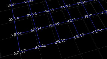

Hi guys. Im new to Houdini and don't really script. Coming from Softimage I am able to do most things I want in Vops & Sops so am enjoying my stay in Houdiniville so far.
I am trying to generate Type (Numbers) that are random to two decimal places. Now, the Font tool and using the Copy Stamp and using the variables. Got that far so I can put a different number on each point of my grid. Currently I have an attribute that I am creating a random number for in a Point Vop (could be quicker with wrangle Im sure). And that random number is the number copy stamp of the font is making. Awesome.
My problem is I can either seam to get my VOP to make a number that is an integer (by rint) or a number that has lots and lots of decimal places. there is no way to round it to two decimal places easily. I tried using nodes to multiply the number to make it big, then truncating it as an integer then dividing by 100 etc to introduce decimal places. but that doesn't work either.
How can I make a random number between a range but have it stick to two decimal places, and yes have a zero if its a clean 10th so it might be 14.30 for instance.
Any help would be awesome. This is automatic option in the type tool in Maya but I really want to keep this in Houdini if I can.

I think you are looking for sprintf [www.sidefx.com]. You can use
sprintf("%.2f", f)
to get a string representation of the floating point number f rounded to two decimal places, padding the right with zeroes if necessary. There is more information on the formatting available in the printf [www.sidefx.com] documentation.

Hi, here's a vex approach (assuming I understood what you were after).
H16.5.268 Indie - font_rand.rar
Edited by galagast - Nov. 10, 2017 17:41:17
font_rand.rar (11.4 KB)

If you are in New York I will buy you a beer, just say when.
This is awesome and very helpful
**that being said, come on sidefx - lets add some versatility to the Round to Integer (make it rough and be to integer or decimal) and have the ability to truncate as well easily***
Thanks so much galagast!
