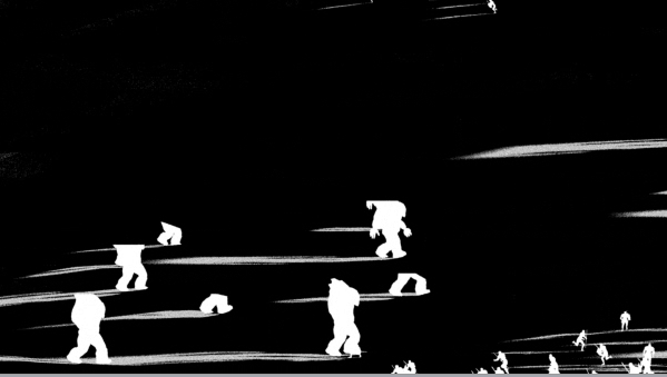

Hi. I don't know how many people actually go crazy with crowds and render them but after simulation fun, all the flipbooks, there's rendering nightmare. I solved many issues but this just beats me - does anybody know what could be the cause of random parts of the agents disappearing? The smaller ones, knights, are taken from Mixamo and they never flicker, but the bigger ones, baked before and and all that stuff, just go crazy. Some of them are ok the whole time, some of them partially disappear and reappear. I'm out of ideas. They're ok in the viewport.
Some short videos:
I've attached a screenshot.
Is it the scale problem? (they have a scale of 3, with some randomization). But why do we have scale then… I put them in separate network, so after the sim each group is in its own GEO node, because at first it seemed to solve the problem, but no - different frame and it's back again. I've reopened the scene, restarted the computer, rendered several times. I've removed the shader, changed it to simple Principled Shader without any adjustments - nothing helps

My guess would be that there are bad bounding boxes for the agents - does Mantra give you any warning during the render about out of bounds geometry?
Ok, I think that's a good guess Thank you! I put Verbose level to 3 and see the messages:
Procedural generated out of bounds geometry
Actual Box: (-14.1973, -24.3555, 24.4797) - (-10.0625, -17.6432, 30.9894)
Specified Box: (-13.5555, -24.2203, 24.9912) - (-10.8644, -21.4461, 27.9729)
This message is also printed for the smaller agents, which render properly - why is that? I would never guess that New area to me. Especially that the same agents render in different ways - sometimes only the legs, sometimes the torso with the legs. It varies. Shouldn't the bounding box of a given agent always be the same?

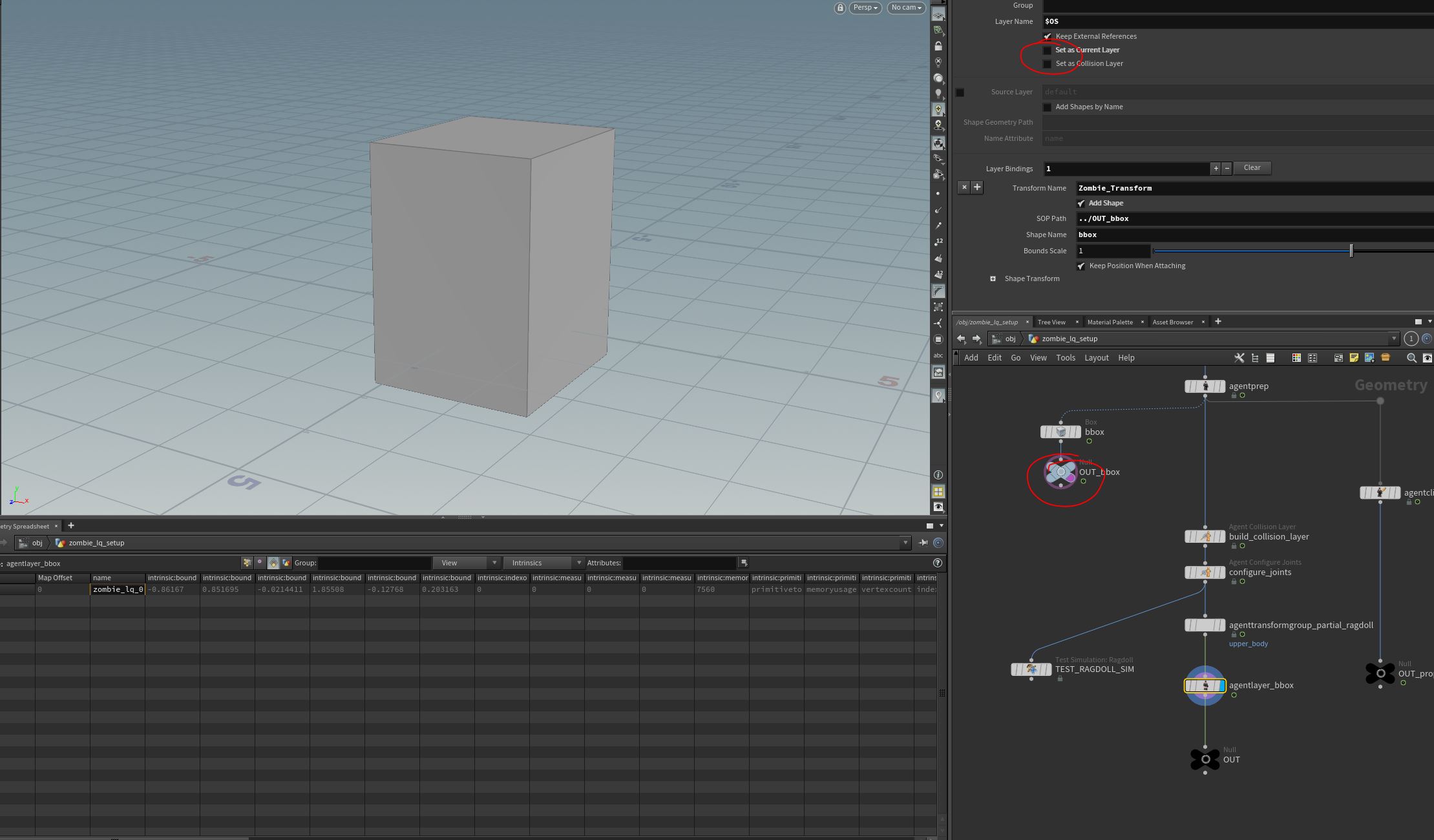

Here's another possible solution:
http://forums.odforce.net/topic/32119-crowd-sim-missing-parts-in-render-random-and-changing-between-frames/ [forums.odforce.net]
Edited by Lukas Stolarski - Jan. 19, 2018 15:49:24

Yeah, Ive got a similar problem coming from the Agent Collision Layer SOP. It clips my agent during rendertime. I just cant figure out a way to get around this. Only way is to disable the collision layer but then I cannot use ragdolls in my sim. Ridicilous. HELP
803 posts
Joined: Oct. 2012
You can change which layer is used for the agent's collision layer at any point (e.g. post-sim) with the Agent Edit SOP. The collision layer doesn't need to be named ‘collision’
29 posts
Joined: Oct. 2015
Hi all!
That collision layer made my life hard but I realized that you can add a collision layer after simulation just for this issue. I created a boundingbox cube layer and added it after simulation.
Just remember to untick the “Current Layer” and “Collision Layer” in the agent setup step so it wont mess with ragdoll simulation or viewport display.
Edited by timjan - Oct. 25, 2018 04:46:35
