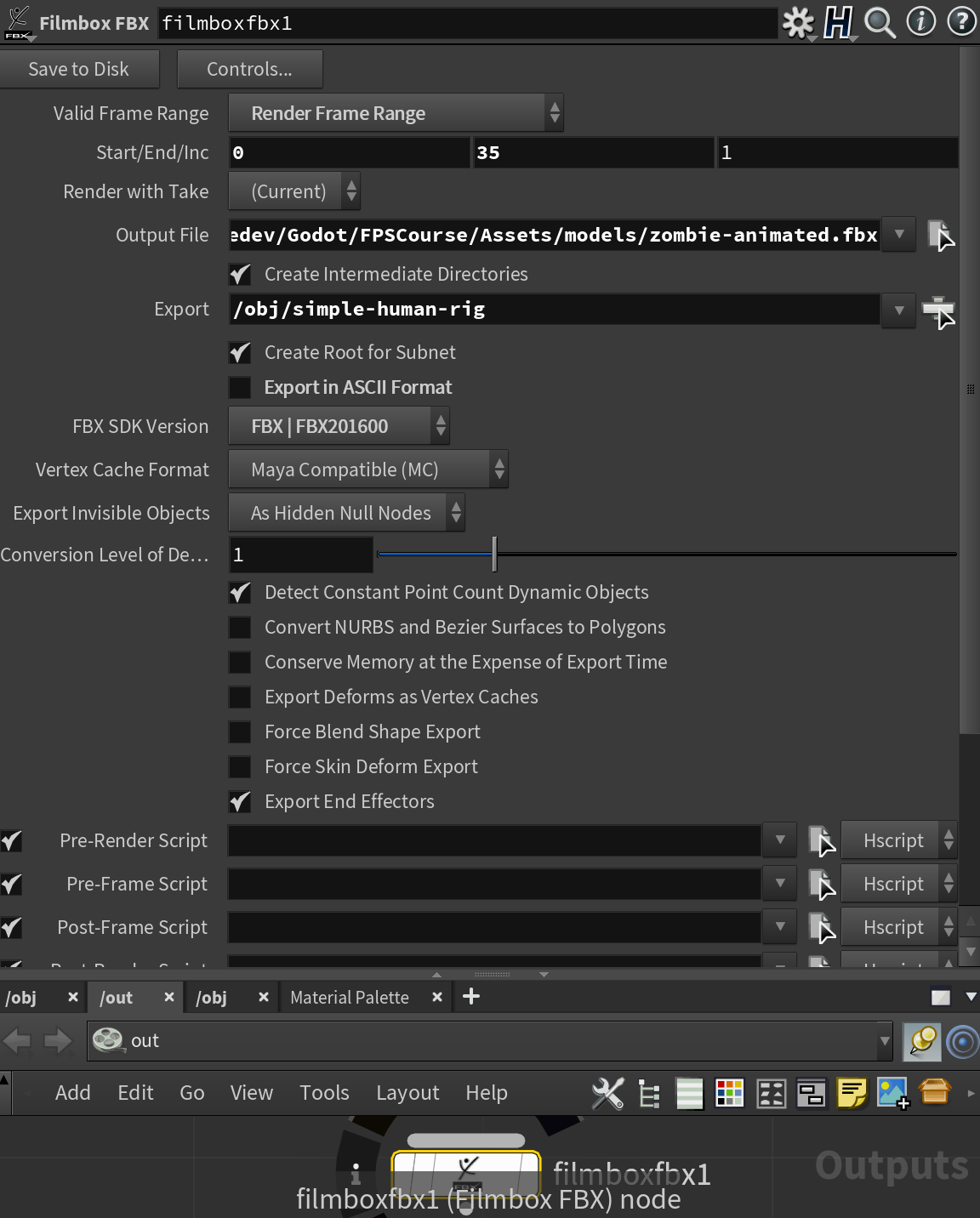

Hi! I'm using Hou 17.5 in Mac OS Catalina.
I need to export an animation for a game, with multiple animation clips in the same fbx file.
But the "Export Animation Clips (Takes)" option is missing from the FBX ROP node on Mac. It is there on linux version.
Does anybody know why? Is there any other way to export multiple animation clips?
